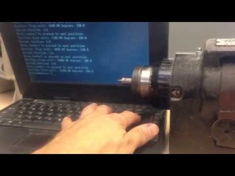

    After I got everything into the enclosure I started testing and I was losing steps... about 20 to 25 in 360 degrees (14400 steps). Argh! I was always spot on when I was testing. It didn't matter fast or slow. I thought the stepper was possibly slipping so I pulled the indexer apart because I had over driven it last night trying to squeeze more speed. My business partner stopped by and suggest I grease it... spent a bunch of time fitting a new zerk and getting it pumped full of grease. Still losing steps. Finally re-assembled everything to verify it still worked on the original control. Clearly something changed when I put it in the box. I started by hooking a cord up directly, bypassing the plug (and it's filtering caps). Spot on so I chopped out the caps... but still no luck. Then it dawned on me that the amphanol 97 connector was never grounded when I was testing. So I bonded the DC negative off the capacitor to the chassis. WOW! problem solved. Hours of work for 3 inches of wire!
    It's really a good reminder to bond the negative on linear power supplies. I should have know better... code requires it on dc systems powered off three phase... why would single phase be any different.
    I was wishing I had encoders. Steppers drive me nuts sometimes.
    I shot a quick video with my cell phone if you want to see it run. Enjoy.
    YouTube Video:
    Click here to view on youtube
