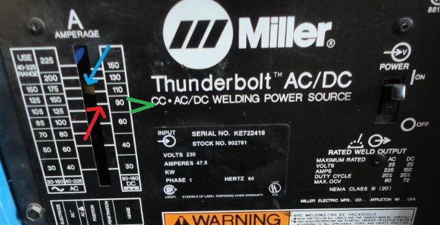

    I think on that particular bead I tried the step method where you step back and then move forward again to fill the crater. I didn't know 7014 should just be dragged straight, when I do that it seems the bead is quite narrow.
    As for how many amps, well I don't know how to read or set the exact amps on this machine. For example, is it 90amps when the 3/8" wide indicator (blue line) is centered between the green lines? I assume the green lines indicate a range between perhaps 70-100?

  6. #56
    Dec 2015
    Western New York State, USA
    1,578
    Re: MIG vs. Stick welding differences I've noticed
    Quote Originally Posted by stioc View Post
    the numbers dont mean much and are often off a bit.
    1/8 7014 100-145amps on DC
    when you burn rod in one use and break arc and last 2" of rod is red hot you are about 145 amps the max they recommend
    if you try to weld at 90 amps with 1/8 7014 rod on 1/8 thick plate it will be harder to control
    most people would use 3/32 7014 at the 75 - 95 amps recommended on 1/8 plate as it is easier to control. you weave if you want a wider bead and put more heat into weld in general you do not weave and go straight and drag with big rod at high amps cause if you go slow and or weave you will burn a hole in the plate from too much heat.
    in general for 10" of rod you want 5 to 10" of weld
    you see cold arc starts and slag entrapment more when you fillet weld thick plate with rod way too small a diameter
  7. #57
    Jun 2012
    Bemidji MN
    12,741
    "Exact amps" is not really what those gauges give you. More like "repeatable setting based on what I like"
    But, when using a machine with a pointer like that - turn it all the way to the bottom and see where it points in relation to the lowest amp reading.
    Do the same at the top position. Bend the pointer as needed to match.
    Now you have a reference that's as close as you'll get with the dial you have.

    amp marking on machine dont mean much
    i took a weld certification test using 1/8 7018 which normally runs 100-150 amps. i had machine at 265 amps welding vertical up. obviously the machine markings were off
    it was part of test to fail any welder who believed welding machine amp markings more than how the welding rod burns and looking at weld puddle and arc.
    when welding rod is orange to yellow white hot its full length you are at too high amps for the rod size. best to keep it dull red or less

  11. #61
    Feb 2017
    38
    If I put a DC clamp meter around the +ve lead I should be able to tell how many amps right?
