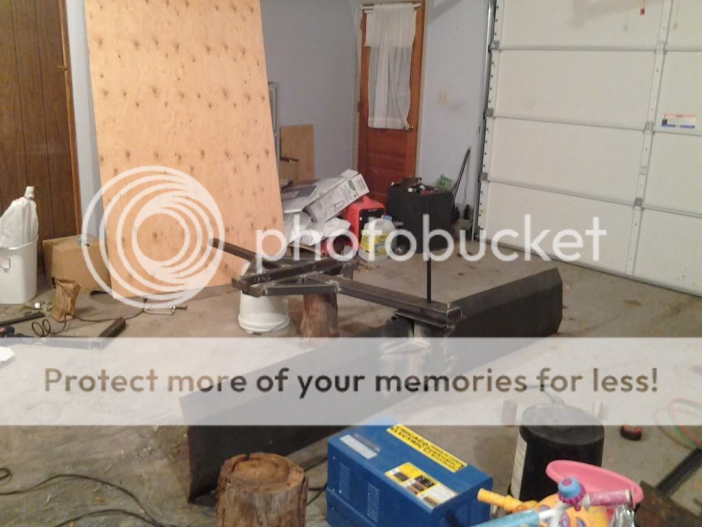

    I have been researching doing this, and haven't found much, but finally came up with a design based off one I found that looked to be the best one. I know most would say just get a B&W and I did, and gonna take the ball out and reuse the hitch for another truck down the road or sell it. Here is the one I am using as a base design. http://www.dieselplace.com/forum/sho...d.php?t=319152
    If the upload works theres a paint drawing of my basic plan minus 5/16 braces on the reciever. Main plate is 6" 5/8 flatbar, and the frame braces are 3in by 5in 5/16 that will be bolted to the frame and flatbar with 5/8" grade 8 bolts. I know this is about 140.00 in material, and the BW is only 390.00 or so, but that takes the fun out of making things yourself that you can. I feel like I need to get the most out of welding school by making as manything myself as I can. I am really surprised to find that no one on here has tried to make there own hitch, and I don't mean screwing a ball to a piece of flat sheet and then bolting that to the bed. LOL

    I'm not going to comment on whether or not you or anyone else should make your own hitch or not, but I want to comment on the design shown in the link you attached. Regardless of if it holds up or not, that dude's crude hitch devalued that truck way more than what a good aftermarket hitch would have cost. I'm talking specifically about the size of the hole cut out of the bed and the fact that the ball&hitch are in fixed position and everything is welded in place. If he had to sell this truck, there are a lot of people who'd be really turned off by his modifications.
    I have no idea what your vehicle is worth and I don't care to know but the example shown is not something I would mimic on anything.

    I agree. I am putting mine in a truck i paid 2000.00 for. I am also using all the hints from the other people about braces. I wasn't gonna weld it to the frame anyways, but I do like the ideas that others came up with to make it better. I have a 2003 dodge I am selling that the guy had a "professional install" and they welded it to the frame since the gooseneck hitch they used was a universal kit and rather than come up with something to attach it to the frame, they welded it. The welds are definately not up to par either. Mine will be removeable, and the ball will be able to flip too.

    I don't favor plates, although I do have a hitch on my Dodge which is just some flat plate on top of the bed floor, bolted to the frame web via L shaped pieces. This was something I threw together many years ago before I started welding. It's seen a lot of heavy service.
    Now I favor a beam setup. A set of small beams (channel) carrying the load to the frame, stiffened for fore and aft movement by a web of plate. Again, the whole thing is bolted to the frame. This was the method I used to build the gooseneck hitch for my 1 ton. It was a build spread over a bazillion threads, and I can't really find them anymore.
    A simple piece of 3" channel will carry much more weight than the thickest plate (within reason 1/2-3/4" plate). Only place you really need thick plate is where the ball mounts, in order to resist shear.
    All of the welding, in the case of a pickup truck, can be done off-truck so no out of position welding is required. You'll have to remove the bed just to install it. This lends itself to beginners skills.
    When drilling holes in the frame,, remember to drill them in the neutral section of the beam (the center, or as close as possible to the center), anything above/below the neutral position will either be in tension or compression. These areas are subject to fatigue cracking. Not saying you can't drill near the flanges (reasonably near), but if possible keep the holes to the center part.
    As a beginner, I'd reccomend stick welding all the way. No MIG or Flux Core (simply not reliable enough in the hands of someone not used to setting parameters). Stick welds at least have decent penetration even if they sometimes look somewhat lousy. 7018 would be my choice, as it's charpy rated (impact resistant in cold weather), and seismic rated I believe (remember the truck is moving all the time, and flexing).
    If you're a responsible person, and not a haphazard idiot, you should do fine. Remember your responsibility to others when you build something that's gonna be somewhat dangerous if done incorrectly. There's no shame in grinding out bad welds and doing them over. I do it. I'm constantly thinking of consequences.

    I tried to get the beginning of it done today to post some pictures so one could have an idea of my skill level, but my friends plasma needs a new tip and they were closed by the time we realized it. Cutting a 3x3 square hole in the middle of the flatbar to put the 3x3 .250 wall tubing through and gonna have an extra 1/2 above for additional plate, like the B&W has. Here is a drawing of my intended braces on the bottom side. All thick lines are the braces except for the ball sleeve and the pin guide. Thanks for the advice farmersamn. I always use stick when I can, and 7018 is mainly the rod I use.

    Still haven't started yet besides cutting pieces, but I did do some welding in the garage today just for practice. Had to add some legs to a small wood stove I am building and thought I would show you what my welds look like up close. Not saying its perfect, but pretty dang good if ya ask me. Done in horizontal position with 7018 3/32 at approx. 92 amps DC.

    Bead looks real nice. The only "bad" thing I see is that you stopped at the corners. You will want to wrap the welds around the corners rather than stop like you did. This eliminates places where cracks want to start.

    I did do that on a few of them. For the most part I would run it through the next corner so I wouldn't have to tie into it. A few of them I stoped to early. thanks for the compliment. In the past I wouldn't show any of my stick welds to anyone.

    Do you already have a hydraulic pump and tank mounted in the engine area to run the pick up cylinder.
    B&W makes a frame mounted gooseneck hitch, EZ to mount Ez to use.
    Paragraphs would make your posts easier to read.
