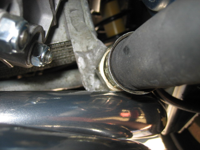

I need to weld about 1" of AL and I don't have AC TIG
I don't have a spool gun either for my MIG. In fact, I don't have much of a MIG at all. Just an old Lincoln tapped 135. But.... I do have some AL wire and some argon. Can I load that in the machine and slowly run it through the cable and try to get a weld on that little 1" long and thin repair?
It's in a tight spot so the MIG torch w/o the spool would be ideal. Any "tips and tricks?"
TIA

Maybe, but don't hold your breath. Keep your gun lead as straight as absolutely possible and you might have a chance. With only 135 amps, you'll be limited to about 16 ga ( 1/16") Much thinner and chances are you'll either have a cold weld, or you'll blow holes in the material. Thicker and you simply don't have the amps to get a good weld. Usually it helps to have a teflon liner installed in the gun. If nothing else be sure and blow out your liner, especially if you usually run FC wire.
Don't be at all surprised if this doesn't work well. Take your BP meds in advance, you probably will need them. Expect to have the wire birds nest on you or burn back and F up the tip. ( have plenty of spare tips on hand) You'll need to set your machine on max heat and crank the wire speed pretty much to 90% or more. Any hiccup and you'll burn back into the tip, or birds nest the wire. Also expect to have to push the bead and travel a lot faster than you do with steel. Mig alum is a hot fast process. It's probably a good idea to have plenty of practice material to run on before you F up something critical.
There's a reason AC tig is THE process for thin alum, and the spool guns and dedicated push/pull feeders are recommended for doing alum mig. You will probably end out finding this out the hard way.
One last thought. if you have an OA torch, there are a number of alum brazing rods on the market that might be a better idea. Yorkiepap has covered their use several times. Alumaweld, Muggy weld, Durafix, HTS-2000, Kirkrod are just some of the names of these sorts of products.
There's a ton of threads on this if you search on here.

Assuming everything goes right otherwise, you're still up a creek if you don't have a handy bottle of 100% Argon. In all likelihood, you currently have a bottle of C25.

I tried this before. I bought aluminum wire and tried to feed it through the MIG... it was a disaster and I spent probably an hour trying to set the tension, feed, etc., up. In all honesty, I don't see it working well. Get a spool gun, or get a TIG. Those are your only two options.

I appreciate the "tips." Yes, I have argon 100%, I mentioned that. Yes I have an O/A set, AL rod and flux. I even have Tin Man's special lens for my O/A goggles. And yes, it's around a 16th but I don't know what alloy of AL. Not soft. This is the task, modify the bracket so the oil line does not rub on the header.
With all the other AL around and the heat transfer, O/A is out of the question. The car is immobile, so at this point it is something I'd like to do in situ. If not, I can drop the motor and start over.

Well, I got an arc and a lot of sticking like you do with Stick or SMAW. I couldn't find the sweet spot between not sticking and burning the wire back to the tip in a ball. I finally bunched up the wire at the entrance to the liner which at this point is not teflon lined.
You guys are right, it's not too feasible with what I have. Too bad I'm only a couple of tacks short of a bead.

Well, you're right, of course. And we did. Less than 5 minutes and 65 dollars later, it was done. I just wish I could have done it because I would have charged the price of a burger and a beer. And had more fun.

Just looked at what you have to deal with and not sure what you want to weld thats aluminum to fix your clearance problem? looks to me like you need to reroute your oil line completely.....2 inches away from that header is still too close in my opinion.....
