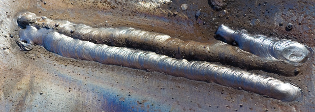

I tried some 6013 today.
Wow. After I ran the second rod, I looked and the slag just curled up and came off in one piece. It looks a lot better than the 6011 did.
1/8 6013 90 amps DCEP

Looks good. Funny to hear people say the tried 6013 one day and have welds that look like yours. It took me, literally, a couple of years to consitently get a good weld with 6013. Now it is my rod of preference and I stick weld most of my project.

Very good. Keep up the good work.

Try it DCEN. What you have looks good.

Looks Good... keep it up...

slag curling off in one piece is a good sign that you have a decent weave, amperage, and speed the rest is fine tuning looks good
although don't expect many other rods to have slag curl off in one piece
