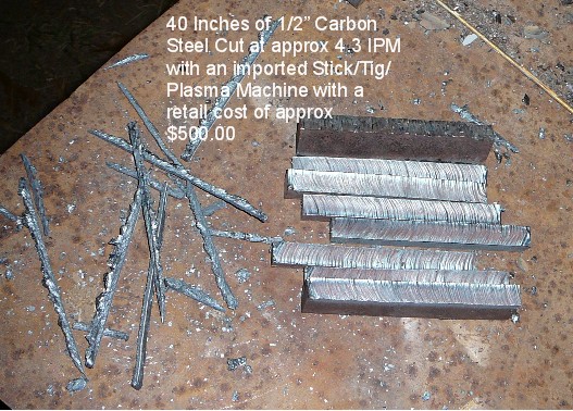

Please forgive as I will probably post this in another forum or two. Since this thread has had such interest and such I figured I would post a few 1/2" cuts I made . My Air compressor gets a little hot when putting out 3.7 CFM at 65 PSI so I used a storage tank to charge up in between cuts.
These cuts were made at 4.3 IPM on 1/2" A 36.
This was not a DUTY cycle test as I had to wait for my tank to fill between cuts. Details about what I did are at http://weldingdata.com/WelderReviews...ast/EV416D.htm along with higher resolution pics and pics of consumables etc.
I didn't cut up any new shiny material or use a angle to make sure I cut straight etc. But maybe my feeling have healed up since the last time.

...I figured I would post a few 1/2" cuts I made...
...These cuts were made at 4.3 IPM on 1/2" A 36.
I tried to visualize the 4.3 IPM cutting speed by taking 15 seconds to draw a one inch line.
Sorry, I guess I wouldn't have the patience for it.
Its a VERY slow cut. Its possible that a faster speed could be used but I didnt use them . I think 40 amps is a little low for 1/2" for any kind of production. But if production is the issue, throw the plasmas away and fire up a torch.
Use the plasma on shiny stuff and those heavy duty auto body jobs !
It does seem pretty slow. I have a little Lincoln Pro cut 25, and it will cut 3/8 steel faster than that, and it is only a 25A machine. And I hear you on the compressor being a determining factor. I KILL compressors, it is not even funny anymore. I finally got a 35 gallon tank 3hp running unit, and for the first time, I can shoot HVLP paint guns without stopping, or killing breakers/ overheating compressors. But still, I can not imagine a cut speed that slow. I'd fall asleep, and burn myself!!!!
From what I've seen here at the refinery shop...I am definitely not a top notch stick welder!!!

Its possible I may try a little more speed but I like to keep the drag lines close to straight. On the 3/8" you cut with the 25 amp, are the drag lines pretty straight or are they curved at the bottom ?

I have a 40 (Hypertherm) amp unit that will cut 1". Slow too, but nice looking cuts. 1/2" is a breeze for it. Anything under 1/2" is like butter until I get to aluminum, this seems to take a lot more.

I cant see this one going through 1" but will have to give it a try. What kijnd of travel speeds do you get on the 1/2". Does the hypertherm use different size tips etc for different thicknesses ?

It looks like some other MFG rate 1/2" at a much higher cutting speed. I may try traveling at this speed and see what happens. I am picturing some fire flying in the WRONG direction but may be wrong.
Pretty straight Gaustin. Well, as straight as I bother to keep my hand and the torch!! Also, if my tip is new, it makes it much better, this is the same for all plasma cutters I think. When I use a guide, I can concentrate on cut speed vs keeping a straight line. When I do this, I get a really good cut. Most of my material is 1/8" and 3/16" steel, or SS. It cuts that stuff fast and easy. The 25 does not like aluminum thicker than 1/8". I use a skilsaw for that anyway, better, faster cut every time.

I just cut 5 pcs each 4.75" Long with a cut time on each from 28 to 35 seconds. So that is in the 8 to 10 IPM range. Either I don't have the skill or the machine doesn't have the power to go any faster than that. I am attached to a 60+ foot long cord of 10/2 wire. So there may be some loss there.
