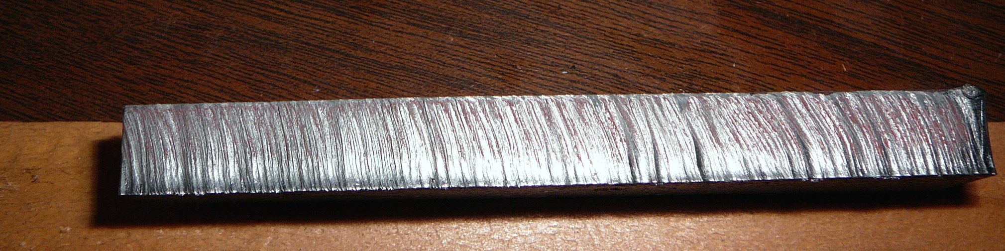

I was asked in another part of this forum how my 40 amp machine cuts. I got the honor of working today, so I took some time out and make a couple of cuts.
HT 600. 40 amps, 1/2" plate. 8" in about a minute or just a little less.

The cross cut I went just a little slower.
Consumables. The electrode is about $7, the cup with a hole in it is about $4
These consumables last 3 to 5 or more times as long as my old unit with a PT31XL torch.
I think half the performance comes from the torch.

The machine welded smoothly during the entire operation. After the welding was done, I switched to plasma and cut the 1/2" plate that I had done the welding on. Though I had cut some 1/2" before, the machine seemed to be struggling. I changed the consumables and tried again. I had to move too slowly for my patience at the time. I had it cranked all the way up and tried various air pressures with no success.
Attached are the actual arc times and modified (not 10 minute cycle) duty cycle times.
During all the time I have had this machine it has perfomed well. I have always used the plasma amperage as an estimate of a practical cutting thickness. Though 40 amps can maybe cut 1/2" well, its slow with the machine I have. I have no way of reading the actual amperage output of the plasma cutter. My electrical supply measured at the plug on the machine reads 2 legs at 115 volts (230).
I also ran a few beads with some Harbor Freight 6013 and they worked pretty well. Especially for 1/3rd what TSC lists them for.

from your posts gaustin, you seem to bid it fairly well. i have some food for thought though, you are severely limited on stick time ie 5 electrodes till oops and then two till oops. also your cutting isn't any more improved over an o/a torch. also o/a has the ability to cut sheet goods all the way to 4 inches and more with a single unit. i don't know what the cost of gas versus electricity and tips would be, but it would be interesting to find out. i doubt that the cost would make a difference. your running two machines to make a cut and spend money on electrode tips. an o/a tip will last a professional a year or better with daily use, i know for a fact that a o/a tip will last a hobbiest 10 years or better.
as far as the tig goes buy a torch and set up off of any dc stick unit. i know it wouldn't have a pedal, but unless you are welding some really thin stuff you won't need it. i doubt the everlast machine would excel at the really thin stuff where the pedal would make a difference.
i think for $600 a person would be better vested to purchase a used cracker box and a o/a set. he would be guaranteed that they work, last a long time, and he could get his money back out of it if he changed his mind. with the track record of everlast a person isn't afforded any of this.
by the way, great looking welds.

I think the overall investement cost for a cutting torch of name brand quality and an AC/DC transformer/rectifier would border the cost for the multiprocess setup.
I lean toward OxyAcet for thicker stuff and the versatility of having a gas torch for heating, bending, tinting, etc can be a great value. On the otherside the plasma allows for minimum distortion on thin materials along with the ability to hold a torch like a pencil. For what little I would do around the house and the cost of a set of bottles, I think the plasma is my choice. The cost of operating the plasma cutter here is about 20-25 cents per hour. Based on 10 cents/KWH. Consumables may be a different point. I may work up something on that.
WIth the GTAW that I do and have done, a foot pedal/remote is of little value but is a nice feature to have. To get that on a Transformer/Rectifier you get up in price quick. I concur regarding the Tig with any CC output machine. Even aluminum is possible in many applications.
I appreciate the comments on the welds. They came out pretty good for just slag welding.
Id be interested in knowing how close my amperage is to what the machine is rated for. I noticed that the amperage rating on the back is based on a lower than normal arc voltage. It is listed at 15 or 16. 16 Volts is low and would require more amperage to melt off a given amount of electrode (I Think). I had recently welded with a 140 amp inverter that was an import but it was stick only. It didn't cut out if I remember right. It had about the same electrode burnoff time but my memory may be failing.
Still all in all for something in the $500.00 range it seems like a pretty good buy. I agree that some of the practices as documented here can be a cause for question. But the machine itself, seems fine.
I will be shipping this one back when I get it arranged with Everlast and I appreciate them letting me use it.
