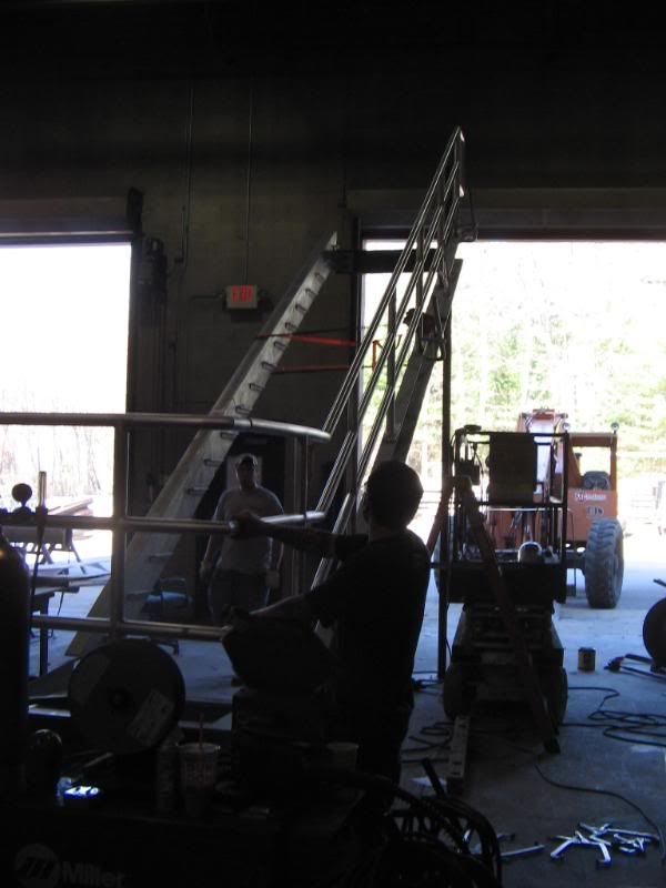

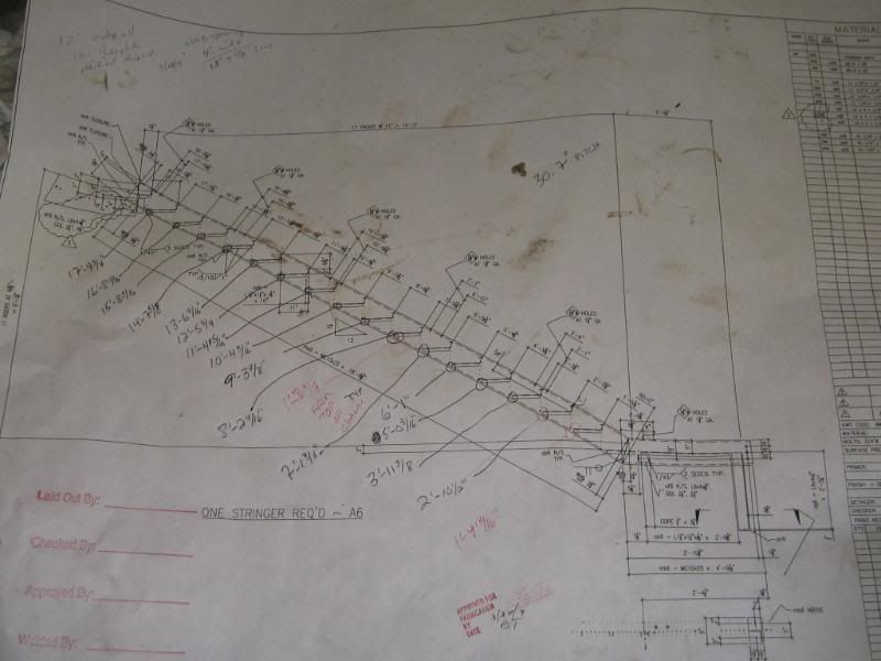

Stairs and Rails

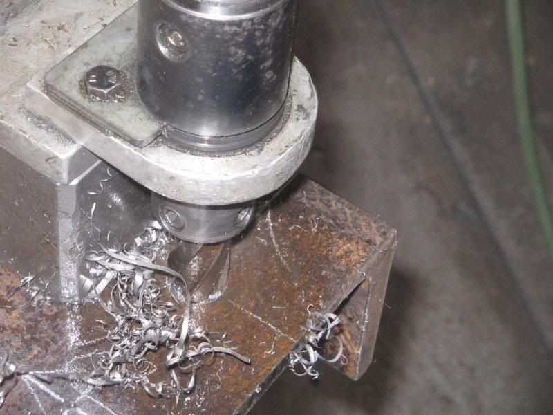

Just some regular old stringers

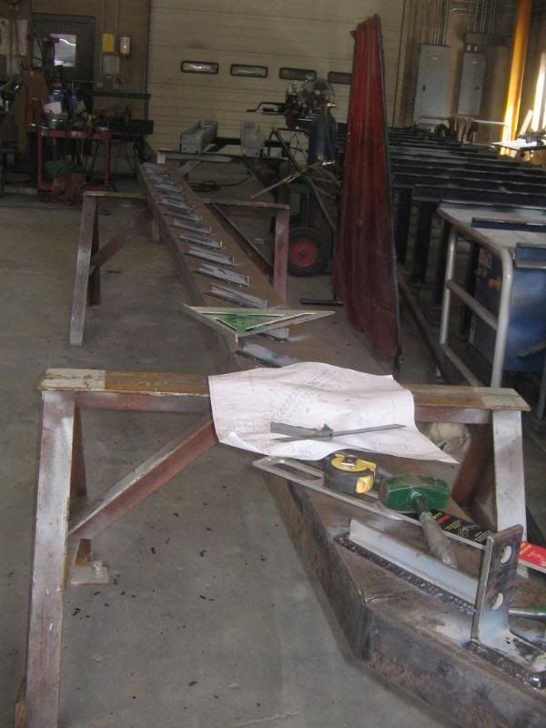

This is the print
Sitting on the horses
Triple 7 I love it
Drillin holes
Done for today
next post

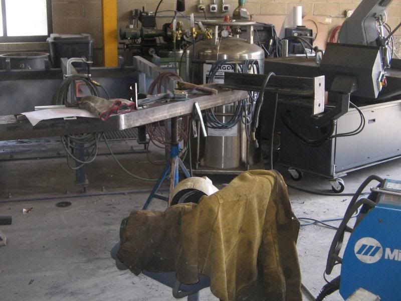

Re: Stairs and Rails
These mount to the stringers
Here is what we are making them from, 1.5" Sched 80 6061 aluminum
The saw
The coping machine
Angry Vinnie with the first railing that took all day
Next

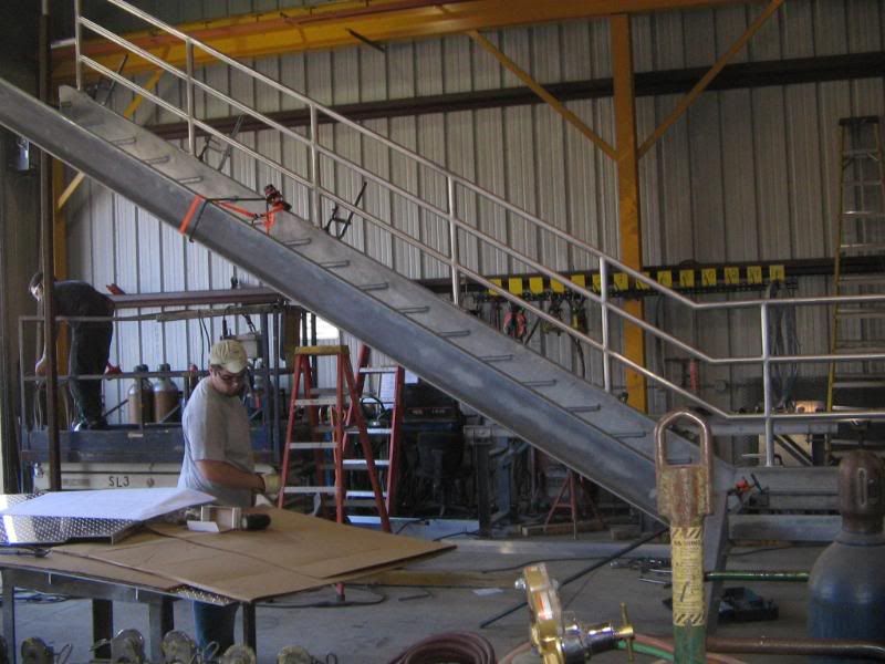

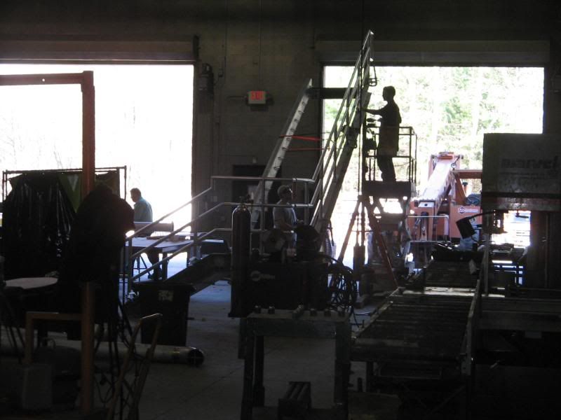

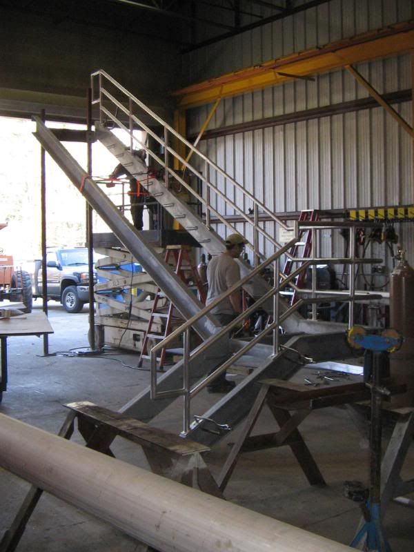

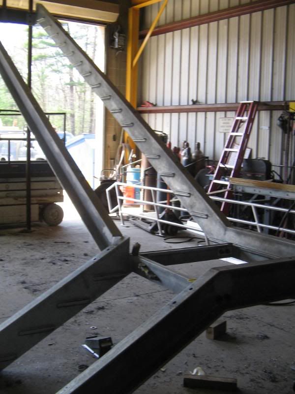

The stringers and rails are back from the galvanizer, and ready for a dry run in the shop before they get installed.
Everything fell together, I only hope the next set goes this well.
Enjoy.

man i dont miss stringers! we used to use a lot of the "jr. channel" to build ours. 12" wide a pounds per foot maybe? i always wondered why we didnt just go with a more heavy duty channel cuz they would warm so bad and we would have to heat straighten them. ill throw a few pics up of the warpage. if we would have welded them like you did the angles we would have had a BUNCH of heating to do. This one was like 3" out.
Very nice. Dry runs a great Idea, too. It can save a lot of time/money/embarrassment. I like to do that on any job that gets galvanized or powder coated. Was the sch 80 spec'd by engineer/architect/end user? Reason I ask is (unless I'm mistaken) sch 40 will pass most codes.

I used to do a lot using 12" junior channell that would warp like El_Lloydeo said. If we were lucky the mate to would be built at the same time and we'd tack them back to back bent the opposite way before welding.......Mike

man that is a great idea. we normally did an opposite hand version. i bet that cut down on the warpage quite a bit. did you still have to hit them with the torch a little bit or did that totally keep them straight?

Not very often, if we did it was just on the ends and usually a well placed belt with a bfh on the edge of the flange (suitably protected with a piece of scrap) would do it.
We didn't weld our clips all around neither, just on each end 'bout and inch or so wrapped around the actual end of the angle and one in the middle. The hardest to keep straight was the crank as there's more weld on the longer length of angle and there usually wasn't a mate to it as the ones with cranks were all the same way...Mike

Sched 80 is what was speced, we welded all around because that was speced for the galvy. I installed them this week they fell in and all the pans fit

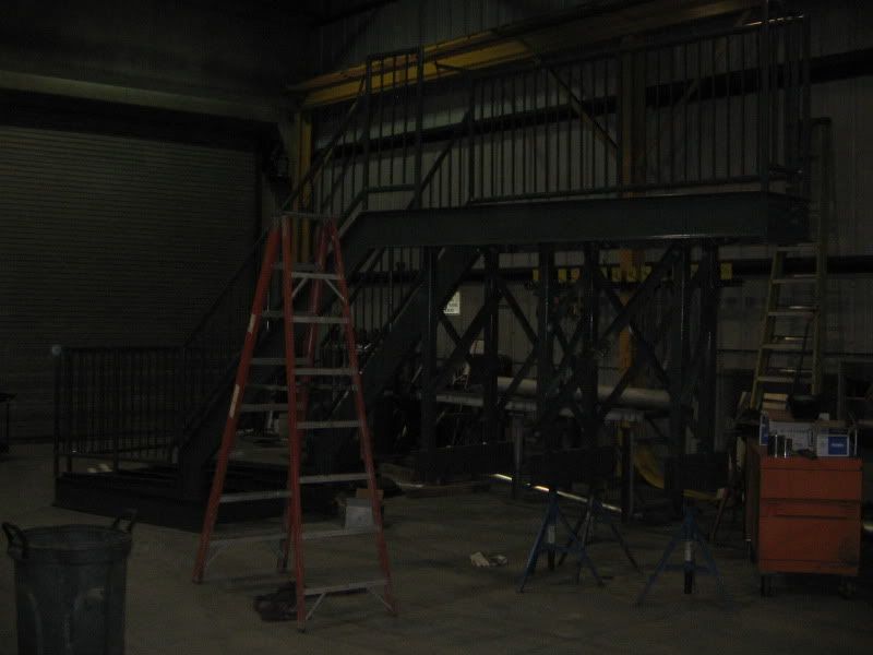

This is the set we just finished as a fire escape, color galvanized.

color galvanized ??

Yup, http://www.duncangalvanizing.com/colorgalv/

Do they give the piping a good looking over for burring and snags when it gets inspected
