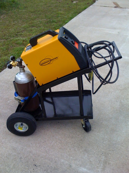

Replacing the paddle fan with the same size ducted fan will make a grate improvement and only one fan needed.
I plan on installing 120mm fan in the front to push out the hot air and give the welder a good cross flow when i can feel comfortable about removing the face plate without damaging it, As for dugndeeps H.F. welder I would go with the 176mm or bigger fan below if it will fit pictured below...

Well here is an update, I have run the welder on four rather extensive field projects and so fare no issues. Two of the trips out I had to weld a lot of 1/4 inch and some 3/8 steel and had to run the welder at the max settings beyond the 20% and more like 30% to 40% duty cycle and it handled it fine. The only complaint I have is the reference sheet that comes on the cover is not at all accurate for a starting point and had to run test welds before welding on the projects.

As fare as I am concerned with Farmersamms posting to my update of the welder I considered it a rude and unprofessional reply but that is water under the bridge now as fare as I am concerned. Dugndeep had ask for an update on how it tested and then I see a post to mine saying when Pigs Fly......
I have around four welders, some I bought new and some that were used mostly Lincolns. All the Lincolns are 220v but I had bought a Miller 140 used and had a lot of trouble with it and It became a black hole throwing money at it on parts going bad, It looked like a good welder on the outside but inside it had a questionable life but I don't rag on miller for the bad experience. I sold it to a guy that needed parts for his own Miller 140. This happened a few years ago.
I then needed a 110v welder and I did not want to spend $700 to $800 for a welder that is used part time when 220v is not available. I did a lot of research on the Northern Welder and It received very good reviews. It looked a lot like my Lincolns and It was being sold by a big outfit like northern tool so I would think parts and service would be good as well. Also since it is a clone of a Lincoln I should be able to use some of the Lincoln parts to fix it if needed in the future.
I started the thread because there was questions that were not answered out there and since I did take a chance with this product I would answer questions and keep everyone updated. But on the other hand I do not need someone telling me that I am full of Poo because he does not like overseas stuff and had problems with a different product entirely.
