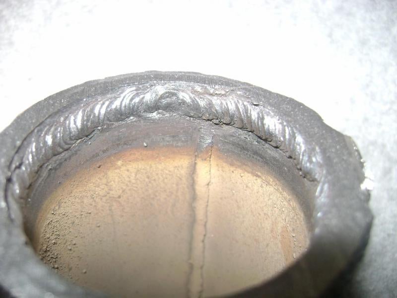

Just remember every weld echoes to the next. You want to be able to place each weld without wagon tracks, or imperfections so you can clean it up with the next pass.
I can't ever remember taking a plate test where I was allowed the use of a grinder. Pipe tests, yes.
Here is a root pass on the outside.
You whip yer root, huh? I was taught to drag my roots, while watching the keyhole. Only time I whip is when keyhole is too big, or fit-up sucks..
