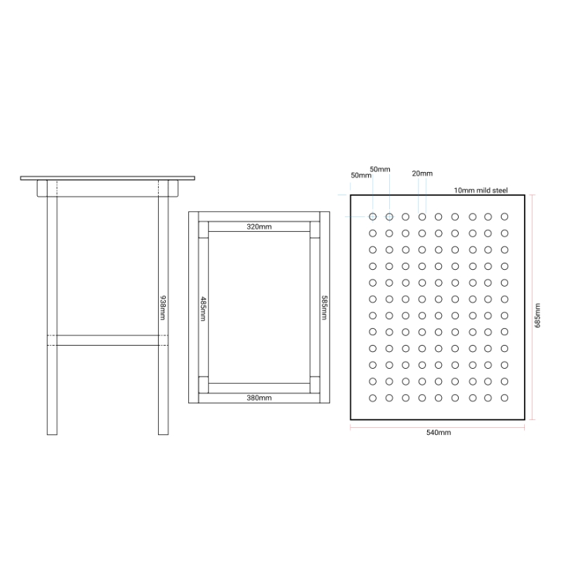

    I don't need a big table as I only have model engineering machines but the fixtures and tools I'm likely to make need to be heavy duty to retain as much rigidity as possible, so I chose to spend the best part of my budget on as thick a top as I could muster.
    I saw a 685x540 mild steel drop going for just £80 on eBay which I snagged and while it is only 10mm thick, its the perfect size for me and I was able to spend the rest of my budget on some 50x30x3mm box section to make the table frame and legs, a length of 30x30x3mm for the leg bracing, set of F clamps and some other welding sundries to boot.
    While I waited for things to arrive, I sketched up a basic design for my table with a view to adding things to it once it's put together but omitted them from the drawing for clarity:

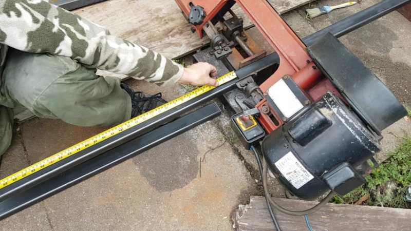

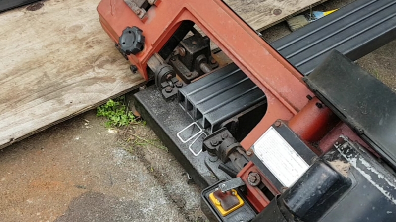

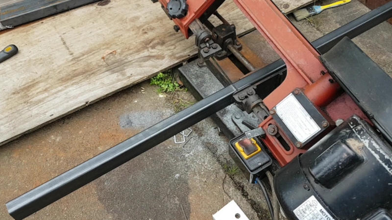

    Was finally able to cut the lengths for the table frame today but the rain didn't hold off long and I had to rush getting my tools inside and the steel covered after the last cut:
    frame legs
    Tried cutting the box section for the table top frame sideways to speed things up, didn't like the finish it left, so continued widthways despite the threat of rain
