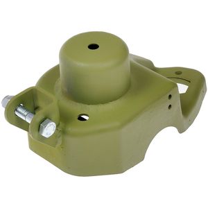

new here and just wanted to ask something (if this isnt the right forum let me know) which would be better for filling in this hole? flux or stick idk how thick the metal is im mainly just curious what to do

Dont just poke at it. Give it a couple healthy wallops with a chipping hammer or ball peen hammer. Like was mentioned…it was caused be rust and is likely a lot worse than it looks. post another pic that shows a larger area so we understand the context better.

yeah took a look at that as well gave it some healthy stabs and whatnot with a screwdriver and nothing gave it's just kind of scaling around it (screwdriver stabs are the best i can do don't have a ball-peen or chipping hammer)
#10 ·
A good fast freeze wire is best for that. Easier to build it up without blowing through.
Flux core(self shielded) comes in a couple of varieties. Lincoln makes NR211-MP, which is a T-11 wire. Or, you can use a GS wire, such as Weldmark, or Blue Demon.
GS wires are more tolerant to less-than-perfect base metals.
By the looks of it, your part is thin..........not much left to actually repair, at least from what I can see in the pic. I'm thinking it's a candidate for replacement.

Might not be nothing left if ground down to clean metal 😳.

This being a spring perch?? They're usually rivetted onto the frame, sometimes welded. Fairly easy to remove, and replace.

for everyone wanting a more clearer picture of the area here it's my front axle i personally don't have the means or money at the moment to have it professionally replaced- which is why I'm asking what would be best for myself to do it, it hasn't gotten any bigger since i first jabbed it out which in my eyes is good it's not at risk of just popping off anytime soon the metal is thin but not paper thin like sheet metal so there's something- I'm personally looking for a temporary solution that'll last as well as a permanent solution- i know that's probably a bit much to look for

If that's an aftermarket lift kit, it's probably in bad shape throughout. You're just seeing the worst of it as you look at it.
I'm thinking that the small hole is just the tip of the iceberg.
Cut a small patch, and weld it up(shrug). Replace it when you have the money.
If that's OEM, shame on them. The dog ear holding the strut will probably go bad in time. Judging by the shape of the axle, and other stuff under there...............it doesn't look like an ancient vehicle.
#27 ·
I'm wondering if it's rusting out because that area is full of crud holding moisture inside. It's on the way out anyway, I'd be tempted to poke a big hole in the bottom so you can weld from both sides, and provide drainage in the process.

I would take that tire off. Compress that spring and get it and the shock outa the way. The bottom chunk under the spring (rubber?) is gonna have to come off before you weld as well. It may also allow you to see the inside of that bracket which is where your trouble started from.
If there is any steel to weld to it looks to me that you could cut a 2” wide band out of 4” pipe and cut notches and slits in it to slide up over that bracket and weld all the way around Including along the shock mount tabs which is where its going to fail next.
But as was mentioned…if you dont have a chipping hammer…What do you have to weld with and what is your skill level. Gonna make all the difference.
I know from long experience that you DON’T want to LEARN to weld on that bracket….Stuff like that falls into the “advanced” welding category

that's kind of what i was worried about- guess i'll take it to a professional- wanted to see if i could do it myself at all- thanks everyone for your responses
#36 ·
It is your coil spring and control arm mount so don’t cheap out on a critical safety part. Get a new can from the dealer. Dorman also makes them and you can get them at Vatozone or Napa.
