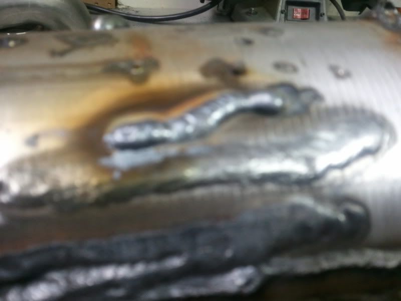

Look at my welds. Help.
23K views 70 replies 22 participants last post by  B_C
Harbor freight 110v arc with tig attachment. No foot control.
Gas set to 16-18
3/32 tungsten, red tip
Turned the heat down to 40amps and went slower.

What kind of gas are you using. Should be 100% argon. Torch angle may be too much on the last half of the weld and bringing in oxygen into the puddle.
Yes it's 100% argon.
#7 ·
It looks like you got too cold and didnt wait until you saw a puddle.I would wait a few more minutes and dip and then move slowly and not to close to the puddle. it also looks like you touched the metal.

#12 ·
The lack of heat control is going to make learning very difficult.
Some of the welds in the pictures have small sections that look pretty good. The problem is that just before those sections you have overlap (not enough heat) followed by sections were it looks like a wide, uncontrolled lava flow (too much heat - or maybe just how you broke the arc).
To manage the heat you will have to
1) adjust your speed. Start slow, start moving faster.
2) adjust how fast you dip. The addition of filler will actually cool the puddle a little.
3) as you get toward the end of a particular piece of steel, the heat will have no place to go and you will need to go even faster yet (good luck!).
4) On a decent welder, you can get a little more heat by holding a slightly longer arc. If you have your machine maxed out it might not be able to keep up. Longer arc means more heat, shorter arc means less heat.
You might be able to find on the Internet people who have modified that machine to at least give you a remote contactor and maybe even remote power control. Of course to do these things right might ramp up the cost of the machine to the point you could have bought something else instead.
Oh, one last thing about practicing. You are doing what I did and its a bad habit. Practice on a slightly larger piece, flat, and draw lines on that piece. First, just follow a line, next draw two lines and make the puddle stay between the lines. When you weld free hand, I can tell you are not learning how to move your hands. You are doing quick, 3" welds which is probably about how far you can move your hand. I would say 5" minimum. For now, stay away from the edges.

A couple other things which might help us give you some advice. Provide pictures of your torch tip. That way we can guage your stickout and see how your tungsten is ground. Also, what cup size are you using?
--Wintermute
#16 ·
No problem I'll get some pics. I am using a number 6 cup. Sometimes I still get a huge flame coming out of it.
Also side note: Where can I find a how to on back purging setup for stainless with 1 tank? I went to weld something that was SS for my car today and DOH used the wrong rod. So I just made a small hole. All I wanted was a tack. Oh well.

Just a quick note...grind your tungsten horizontally, not laterally. The grind marks should be straight to the point...

Good Grief!!
All that spatter on your cup is NO GOOD.:rolleyes:
Bad gas coverage will do that..
Crappy material will do that..
No gas and the metal boils and splat's itself all over everything...
Yeah........"Splat"..:laugh:
Looks more like you had no gas at all at times..Or a good wind got in the way..
The metal itself ...Well more time is needed..
Get to BARE metal and clean it good and try again..
These first pics are exhaust tubing and you don't need to start there..As you can see.
Junk metal you find around the house is no good for this without proper and sometimes major metal prep..
...zap!

What are you welding on? Those dingle berries look like your material is plated or
something that splatters as mentioned........Get some clean cold roll steel to practice on like 1/4 " plate then work your way up to thin wall tubing......Less chance to OVER COOK IT

The material is at a given temperature when outside air hits it and there is an oxidation that occurs. When it's running too hot, you get black, and volcanic gunk. When it's too cold, you get high beads as in some of your pics, and no real color change. When in the correct heat ranges, you will see some color variations; a lot has to do with speed of weld, and gas coverage. A mig weld will show a rainbow out from the weld in a halo like ring; it shows gas coverage and heat spreading back from the steel. Tig is different because you control the puddle and filler differently as you already know.
Keep practicing; this may take you several bottles to get pretty good with because you have no amp adjustment, and a primitive machine, so arc quality is also going to be an obstacle you will learn to weld around.
#30 ·
As mentioned by others.
Wrong material for TIG.
Wrong direction of sharpening of tungsten.
Ceramic cup severely contaminated from aluminized or galvanized material.
You can't beat up a TIG torch like a MIG torch. Won't fly.
The ceramic cup on a experienced welders torch will be unmolested and clean.

To clean the cup you can just lightly scrape with any tool, but the reason the cup is getting contaminated and getting balls of metal on it is from the coated metal that you are working with.
It spatters and then the molten balls of metal stick to the ceramic cup.
You need to work on clean uncoated steel or stainless steel.
They have MIG filler wires just for working with galvanized and aluminized metals.
You can use a 100 grit flap wheel for sharpening your tungsten, or a flat sanding paper on a bench style sander will work the best.
Normally when you are using TIG (GTAW) you stay away from aluminized or galvanized material because of its spattering properties wrecking your TIG torch.
If you had a gas lens in your TIG torch it would be worse because the molten balls of metal spattering all over it get stuck to the screen and they will not come off.
Those gas lenses cost at least $20.
I give you credit for trying, but working with no foot control makes TIG welding very difficult.
Usually with TIG you have the pedal down at the start and let up as you progress and the metal plate is heating up.
BTW in that last photo the brown stuff can be from gas pressure being a little high.
That piece being welded still has mill scale on its surface and that is making it more difficult.
The metal needs to be sanded to clean shinny surface.
