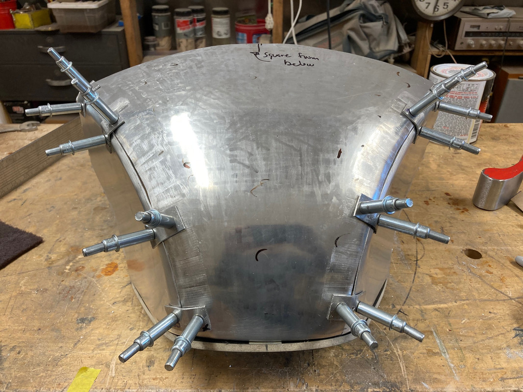

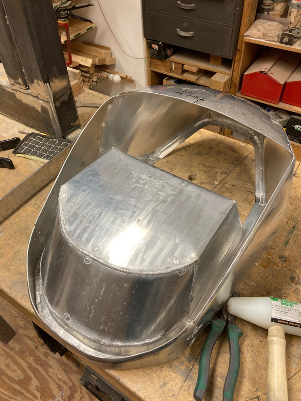

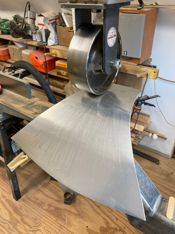

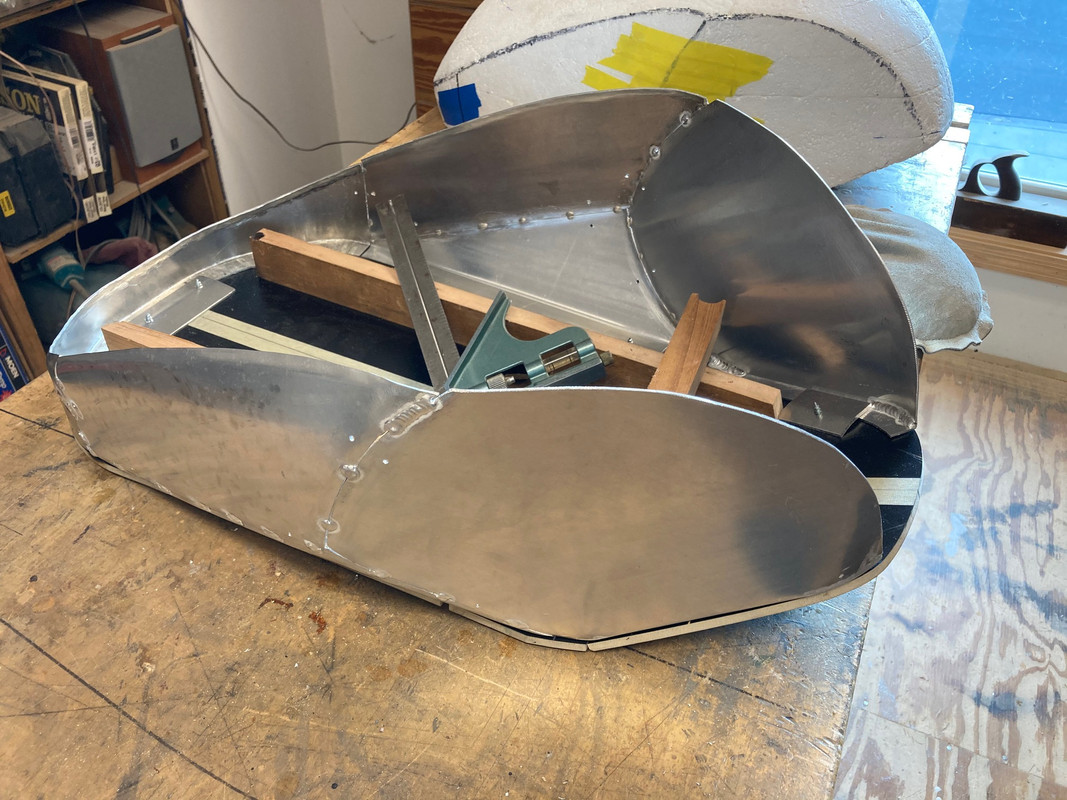

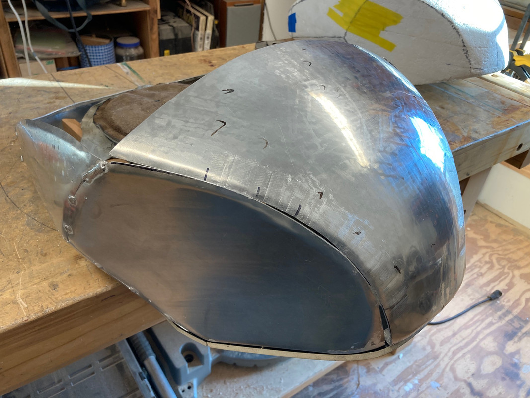

    Working on a tank for buddy.

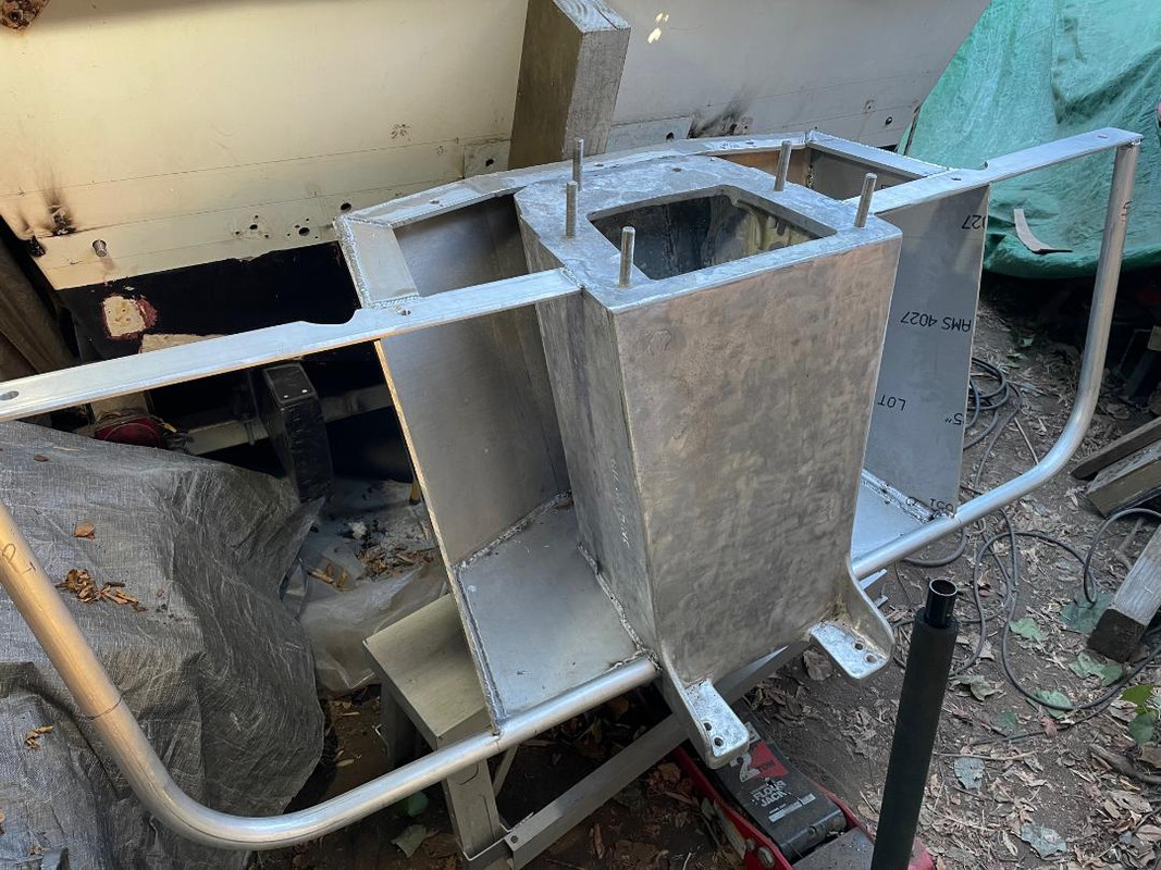

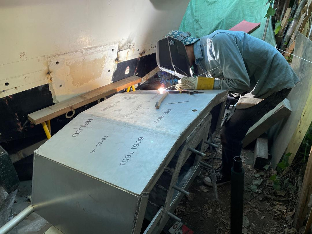

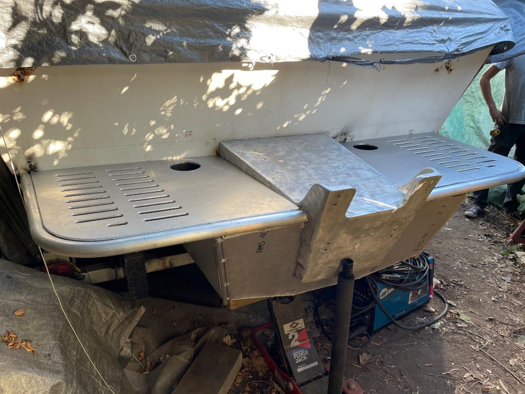

    Made some more progress on the outboard bracket. My helper, Jesse, got a lot more of the welding completed. And we have the swim step top plates ready to install. Also got a chance to try out the new iPhone 12 Pro's camera. Seems to be quite a nice improvement over the old 5s.

    You preheating that boat deck? Looks like some thick aluminum

    The thickness is way overkill and probably unnecessarily heavy. No pre-heating involved. Construction is 1/4" 6061-t651. Tube is 1-1/2" od x 1/4" wall. Mounting flange is 3/8" x 2-1/2" flat bar. Aft vertical corners of tub are 5/8" rod.

    Wow. I’d be using preheat. Your probably just brazing that aluminum in my opinion

    Running a Miller Dynasty 200DX at wide open throttle (showing 195-amps) so I think it is slightly better than brazing. Seriously, should I be concerned? My helper is a certified welder.

    Yes that job takes over 300 amps probably without preheat. 200 with out not a chance!! The guy bumped the tungsten about 12 times too. Maybe a couple but not that many meaning he’s not very good. Failed bad on the weld on the bottom pic to the right on the tube. Adding rod before the puddle was hot enough or bad rod angle. Possibly wind but that’s a rookie doing that job

    I think that weld in the back is a little more challenging than it might appear. I would have trouble getting my helmet close enough to use my cheater lens, and then you gotta get both arms in there while getting a good view of the weld. It looks to me like a very small area to weld in. Is the middle part a casting ? Castings can be difficult wetting out, and often have surprise materials that pop to the surface when welding. Definitely working that Dynasty hard. Is he using a foot pedal or a finger switch ? would like to see what the finished part comes out like, Keep us posted.
    Best of luck

    Using a foot pedal.
    So you think this will fall apart?

    It's an awful lot of metal to heat. Mine is Dynasty 280DX, I believe it's too much mass for my machine. If I tried that I'd either put a great deal of pre heat in it or add 5 CFH helium. 4943 would also help.

    Pics & work ^ ^ ^ - what does the tank feed . . . ?
