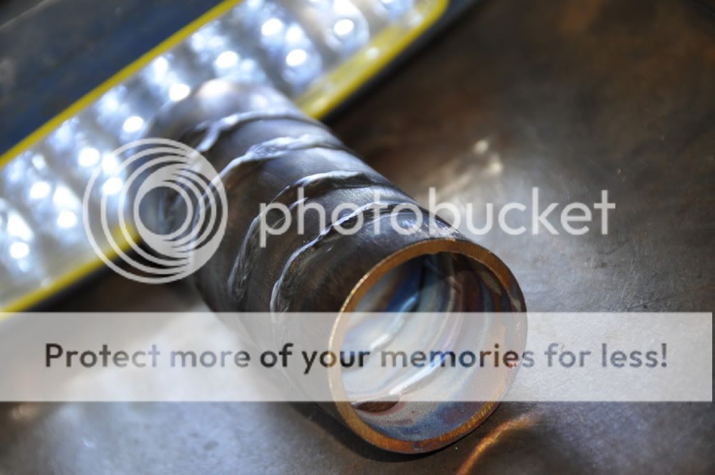

    A motorcycle exhaust I did a couple of months ago. GTAW purged.
    [IMG][/IMG]
    [IMG][/IMG]

    ok, without seeing the insides of those, that welding^^ to me looks to be perfectly adequate as far as functional goes, but not necessarily beautiful "work of art" beads, which to me, at this point & with the project at hand should be good enough for now... functional welds & beautiful perfect looking welds are 2 different things, right now I'd be happy with perfectly functional adequate welds, then grind it down & polish to look like one piece. this is my goal atm.
    since my goals for right now are to be able to weld these seems adequately enough to be good sound welds my questions are:
    1) would I be ok just doing a fusion weld to butted seams? then, if filler was needed to get a smooth seamless finish I could go over it to fill with a bit less heat?
    2) would I be much better served by grinding a v groove & filling on the first pass? for a fusion weld I'm thinking no v groove, just not too sure what the better plan of attack here would be. I think I have a better shot of mastering a fusion weld non v grooved than the later, but if it's not adiquate then I don't want to waste my time trying to perfect something that's not good enough anyway. I guess a fusion weld on a V grooved fit up with a filler pass after is also an option?
    3) I'm concentrating on what the interior of the weld looks like, is it absolutely necessary to be able to see a whole bead of weld on the inside showing full penetration or would it be not so terrible if some spots are not fully penetrated enough to see a bead on the whole inner circumference of each weld? I know the answer to this can be kind of subjective, but I'm wondering if it's not too uncommon for a weld to be considered adequate without showing a full weld bead on the interior. I know this would not be adequate for a sanitary weld for like the food industry, but how is this considered when it comes to headers?
    4) is there any problem heating & then reheating & reheating again as long as none of the heating is too hot to cause carbide precipitation? in other words, is the heating damage cumulative or solely a matter of max temperature on any one pass?
    thank you for any help you care to give, I really would appreciate the input to help guide me as to what I should ultimately be shooting for here

    riceburner.
    those welds look a little to dark or "hot".. when you over heat stainless you lose the beneficial properties of the stainless. also it looks like you went with free hand and added a lot of filler. you should try and walk the cup (takes a little practice but once you get it your welds look much better and the heat input is a lot less because you move at a constant speed. either that or if your machine has pulsing you can try that to help keep the temps lower..
    sorry for the off topic post.
    also to the OP when welding something like this you should really be aiming for tig'in it(takes more time but in the end a near discontinuity free weld once you get the technique down and backpurge). watch some youtube videos on walking the cup practice it and with in a few hours or maybe a few tries you will get it down.

    Thanks for the input.

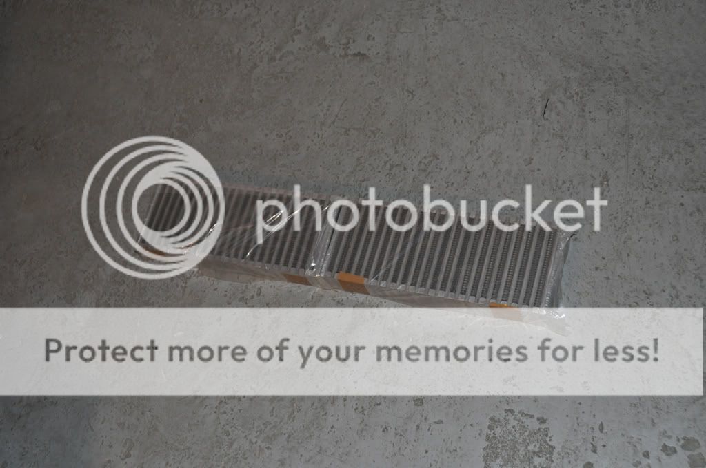

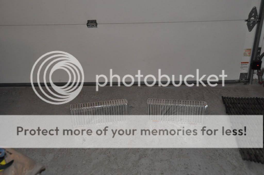

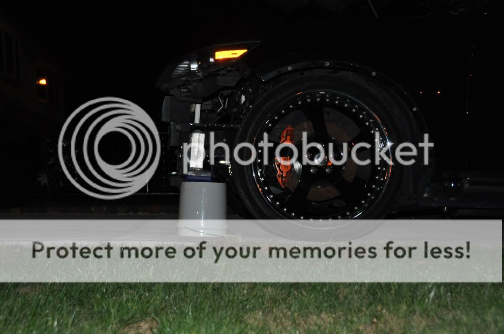

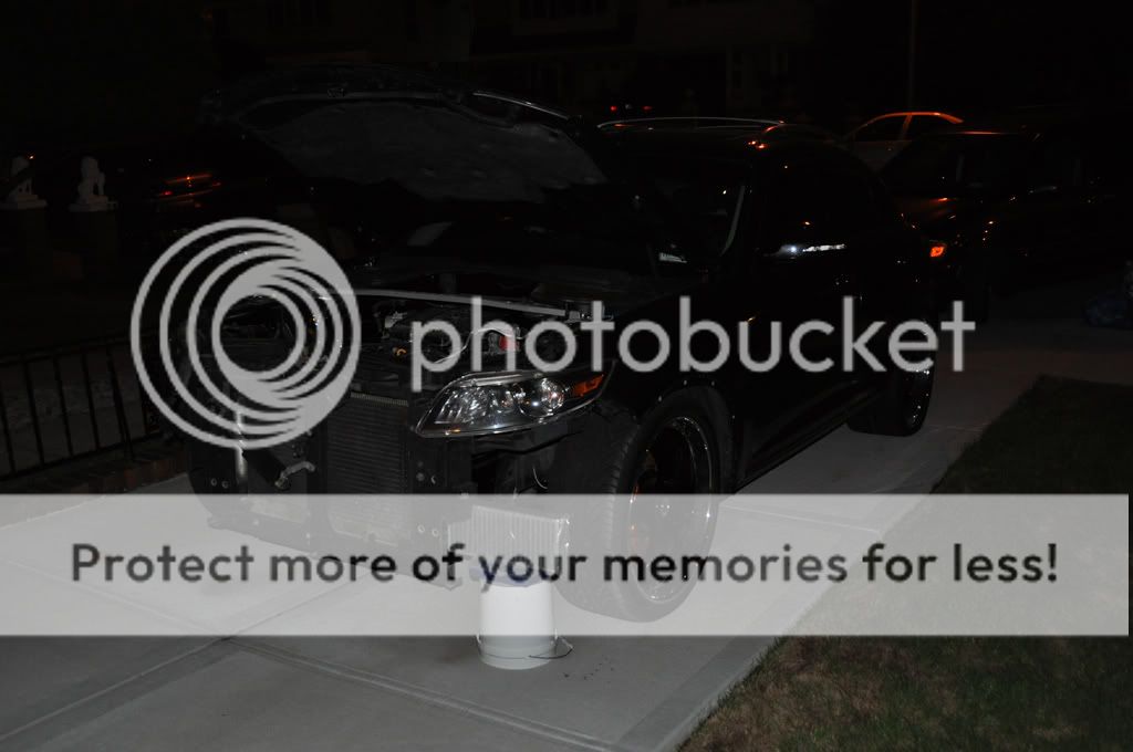

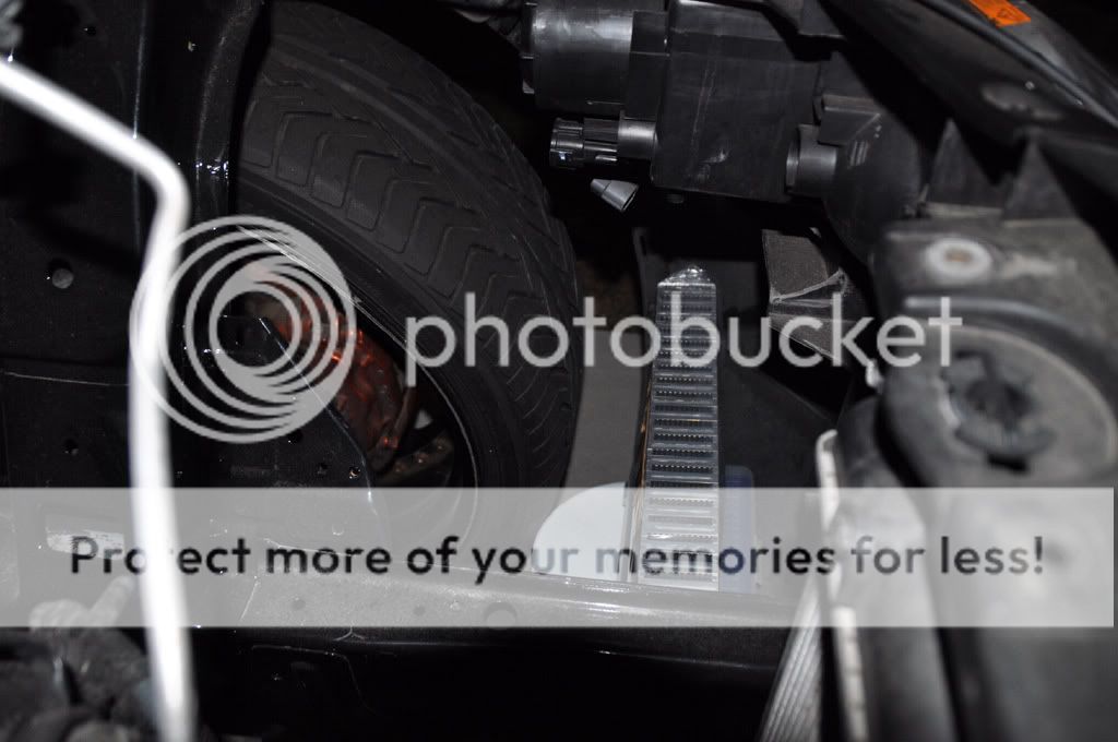

    here are a few shots of the intercooler cores & there placement,
    I custom ordered the exact sized cores that I wanted so I can build for the best fit & flow for my overall design & available space,
    these cores flow enough cfm's to comfortably support 850hp+, although I probably won't ever see much over 500hp
    unless I eventually wind up doing something serious about beefing up the AWD drivetrain a bit ,
    airflow & efficency is going to be very high because of the side mount short tube vertical cores,
    2 1/4" cores & no rear airflow restrictions like having a radiator & a/c condenser behind them mean very high heat transfer
    then there's the very short pipework in plumbing these up because of the close proximity to the turbo & throttle bodies
    these are good bar & plate cores, and with the 1/8" 5052 custom tanks these are gonna be a sweet intercooler setup,
    now I just gotta learn how to actually weld aluminum
    the bumper of course will be custom for these intercoolers, with properly ducted openings for them, that much I already know how to do

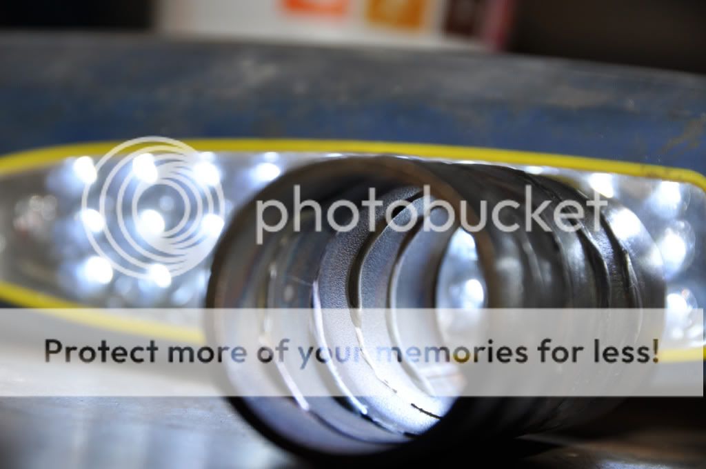

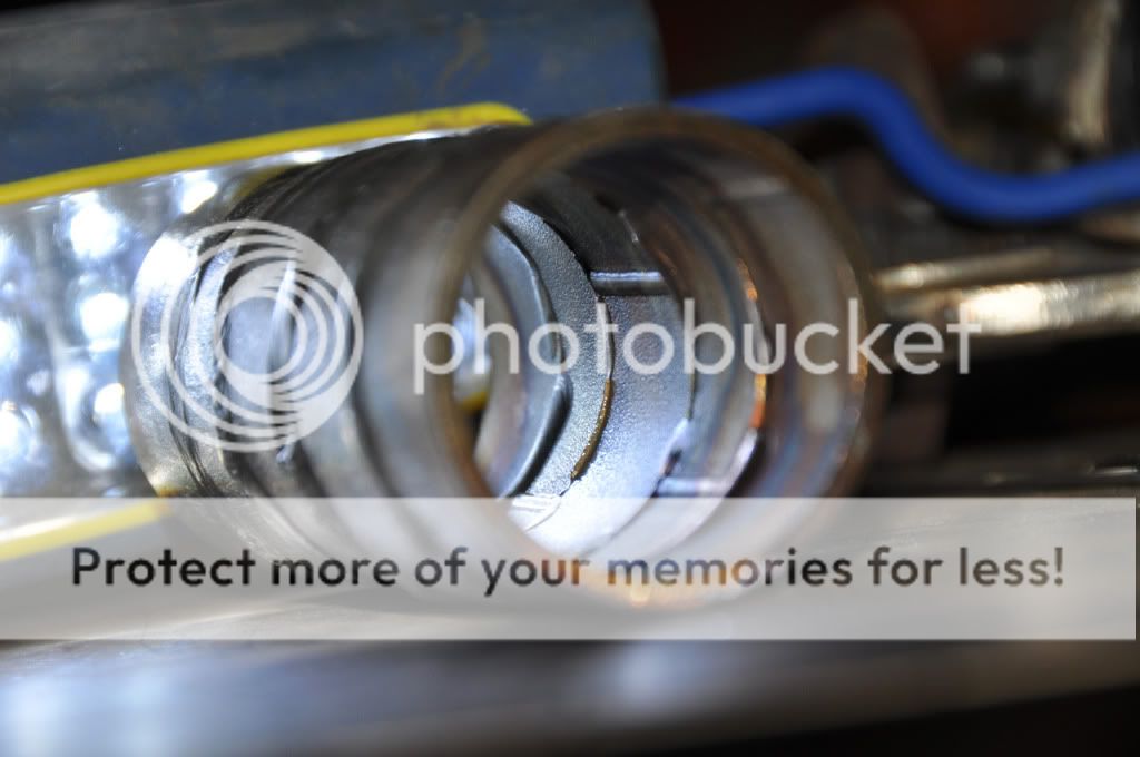

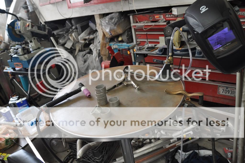

    ok, been practicing & practicing welding this SS schedule 10 pipe for my headers,
    cutting piece after piece & then welding it back together, over & over again..
    I think I'm at the point where I can get pretty good penetration throughout my welds fairly consistently,
    but not 100% to the point of absolute sanitary conditions, as there are still minor voids throughout.
    how perfect does this need to be to be considered ok for headers? is this good enough to be considered good? adequate?
    or do I really need to keep doing this till I get it flawless with no voids at all in the whole interior of these welds?
    how good is considered good here? don't know how much help I'll get with this buried in this thread but I;'ll try here first at least,
    any help or advice would be much appreciated by anyone who cares to share there input
    am I there yet? am I at least close? what should I be shooting for & how far off am I from good enough for headers?

    Still looks like you're cooking the **** out of it. Are you trying to weld it in one pass? It can be done...full pen with good root reinforcement and a decent fill on the cap side but it's tough and I've never seen or heard anyone knowledgable recommened it.It's just a pain in the *** imho. Try it in two passes. One root pass with a feather edge land, 1/16 gap, 1/16 filler and waaay less heat or waaay more speed. Then cap it off in another pass. Your progress might be discouraging at this point but you have kind of jumped straight into the deep end of the pool with this one so keep your head up. I would try to perfect thebutt weld process on 1/8in flat stock first and then tackle the insanity that is changing your torch angle while going around small pipe. Don't worry after a few years of doing it every day it gets easier :P
    This is a sick project and I love it. I would totally weld the **** out of that entire project for free just to have a hand in making it a reality man. I salute you sir!
