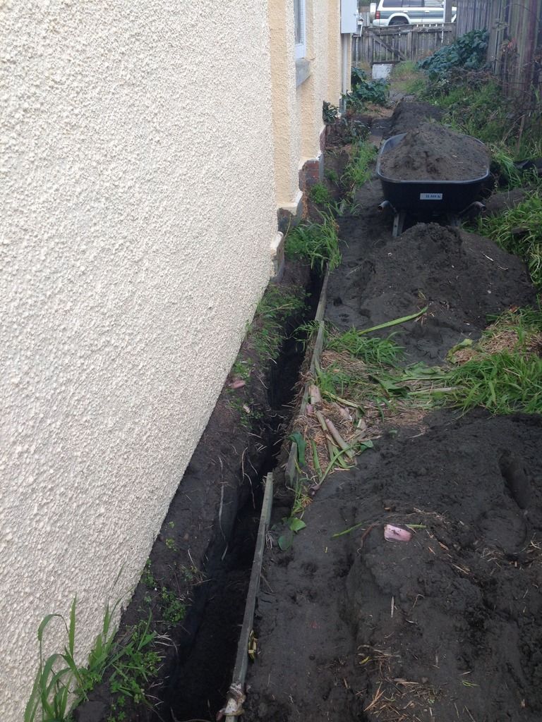

    This will not exactly be a thread of woes, but more of a thread of taking longer then planned. But its happening.
    I notice over there in the USA you guys have a little war with your power companies regarding getting 3 phase power in your shops. Also for some of you it costs tens of thousands of dollar to get it. I also notice that your power supply voltages vary a great deal that all in all it is damn confusing.
    Down here in kiwi land all our power poles have 3 phase lines along the top row. Single phase supply gets tapped off of the poles and distributed to each house. Single phase supply is 230-240volts at 50hz and 3 phase supply is 400-415volts 50hz. Single phase is commonly referred to as 230volt and 3 phase 415volt.
    Most household single phase wall sockets are a 230volt 10 amp socket. For more higher rated single phase devices you can get a 15 amp socket.
    3 phase sockets can be a bit amp specific, so you would obviously buy whats right for your equipment/wiring. I had a new garage built a couple of years ago and have been on a quest to have 3 phase installed since that point. I got lucky as there is a power pole right outside my house but what was even more lucky is that right outside my gate is a 3 phase distribution box that was plonked there when the people next door built a new house which was so that they could tap the single phase off of it. There is however a massive 3 phase cable going from the pole to that box which I got the great plan of connecting to.
    So the journey began with a trip to company that looks after all the lines and maintains all the power supply in my area. I told them my grand plan and they were all for it however did inform me it would be at a cost of almost a couple of thousand dollars to hook up to that box. We (myself and the lines contractor) tried for a 415v 100amp supply but unfortunately we could only get a 60amp supply due to power restrictions in my area (long story short the power company have maxed out the local transformers which is a bit dumb as both transformers near me have been often taken out by trucks).
    They put the required 60amp fuses into the little distribution box and I proceeded to dig a trench through my front yard to hook up to it. Which my awesome electrician nicely did for me. So I am currently only running single phase but have the 3 phase cabling thats required going from the street to my house meter box. After that I had some financial delays but am back into it.
    Now is the journey to go from my house meter box to my garage and have a 3 phase meter installed and the extra phases connected at the street.
    The first half of the journey all I did was the leg work for getting permission and digging the trench. But for the second half I am doing as much as possible myself so that my electrician can do what he is required, as here in New Zealand even though I am not an electrician I can run cable and do a lot of the grunt work but any connections to the meter box and main power supply have to be done by an electrician and anything I do will have to be up to code and inspected.
    Things I have learnt so far, 3 phase is expensive but worth it in the long run as most industrial stuff down here in 3 phase and equivelant single phase stuff is crazy expensive. Also no matter how worth it you think it is, trench digging is not fun at all. Also the local council really know bugga all regarding whats under the ground as I found a bunch of old pipework under the ground that they did not even know about.
    I have no idea what you want to run but that should come close to running 100 hp motor if needed, that is a lot of potential power,
    I realize I am a small user, and do not even have true three phase, as I have open delta three phase, (one transformer missing, and and only two of the three phases of the three phase coming to the farm), (used where most of the load is conventional single phase), but it runs my mills and lathes and compressors just fine, I think I am not recommended to pull more than about 25% of the load, that the breaker is rated for, as the transformer that produces the " third phase" is down sized, and I have a "100 amp @ 220 volts",
    It is was a cost saving set up by the power company, they said if I need more power they would come in and up grade the system, no charge, (one line man said there is a transformer at the storage area with my name on it all ready), but I have done fine with this set up, (not sure how it would work with a three phase welder works fine with rotary equipment).
    If you over load that 60 amp entrance you have other problems,

    Yeah I am sure it will be plenty. I am just planning for the day that my Syncrowave 351 comes home from work. It sounds crazy but if you read the manual for a 351 and read the recommended electrical connection for a 351 running on 415v 50hz you practically need a 60amp breaker just for that haha.
    I'll be a one man band when my home shop is properly setup and running so it will be all good as I will only ever be running one machine at a time.
    Even though Syncrowaves are single phase in the states, we run them on three phase circuits down here to get the voltage.

    Quest continued today with running cable. From the street to the house is whats known locally as 35mm 3 core neutral screen made by General Cable. In easier terms its an underground rated 3 core copper cable used for 3 phase installations. That was installed about a year ago. From the house to the garage is 25mm 3 core neutral screen made by Olex cable. The reason for using the bigger cable from the street to the house was price. We found the required length of cable for a very good price but it was of the larger size. Which can never be a bad thing.
    The cable I ran today is the 25mm and is over about a 100 foot distance but can handle 153amps when buried direct and over that distance has less then 1 percent voltage drop.
    I went to the local electrical store to get insulation tape as the cable will be exposed to the elements until the connections are made. When I explained what I was doing to the guy who works there he showed me these shrink fit cable covers, they are filled with glue to create a good sealed fit when shrunk. Though I do question the the thoughts of whoever invented them as while shrinking them they just got more and more phallic looking. Weird. The staff member at the store was impressed that I wanted to protect the cable in such a way as apparently a lot of people don't think about that.
    Still put insulation tape on just for good measure, can never be too well protected.

    Ok so update. I used to have a 351. I now have a 350lx. My 3 phase has all been installed and my Syncrowave is hard wired as that was the economical way to go. I wound up going with batten style LED lighting just because I wanted to prioritise power for the machines. LEDs do just fine without using much power.
