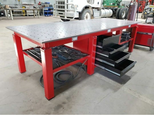

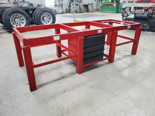

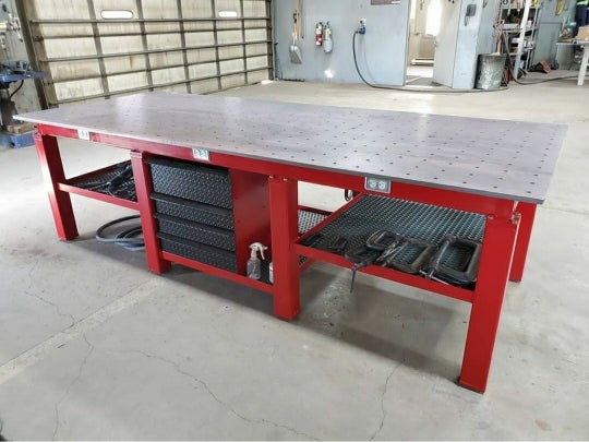

    Definetly add a bottom shelf or 2. Here's my latest build, little overkill for what you're wanting, yep, but hopefully a few ideas for ya.
    Sent from my SM-G970W using Tapatalk
  26. Likes psacustomcreations, Oscar, 12V71 liked this post

    thanks for the advice everyone. I've already started trying to decide how I want to mount my vise, and some storage options for clamps and tools.
    JayWal that bench is insane! incredible work.
