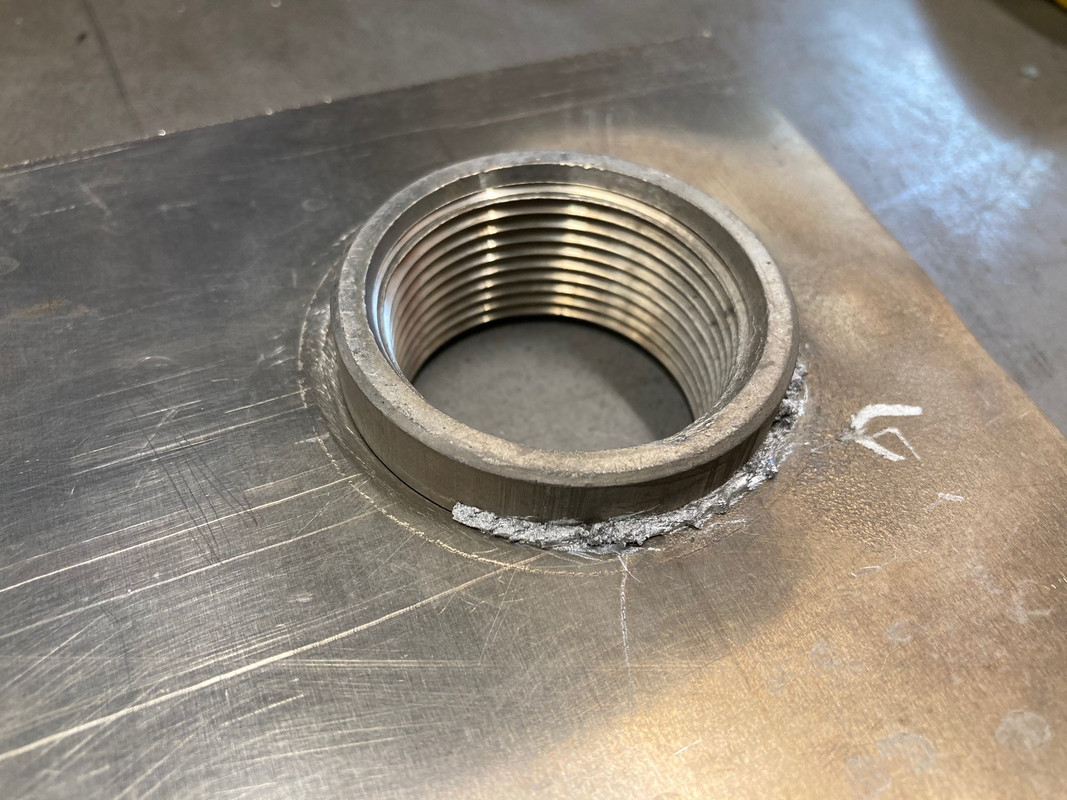

    Does any one have experience using any of these aluminum brazing or soldering products? I want to fasten a filler neck into a sheet metal tank. I want an alternative to welding that wont distort the tank and would allow the neck to be removed later without destroying the tank.
    Here's a picture of the first one I tried with a low melt rod for practice. I think it's the one from Magtorch, I give it double thumbs down. It claims to melt at 700F but by the time I got it even close to flowing my base metal had slumped.

    Are you scratching the surface with the rod. Scratching breaks up the onsite that forms as you heat. Doesn't look like you brushed it at all. But as heating vigorously scratch the surface. Your heating the metal not the rod. So you want concentrate hear on the bushing while scratching the joint. It will flow shiney/smooth.

    OK. I tried to scratch at what I have while heating and it never really wets out like I've seen in videos of the HF product. I see others also use the scratching method to get it to wet. The product I have just won't seem to flow so I think I need to make a trip to HF.

    you have to clean the surface before using those rods, the oxidation on the surface wont let the rods( wet in )..use a stainless steel brush and make it shiny, heat the heavier piece first and rub the rod into the surface, it takes some practice , but works good once you get the hang of it...I use a small propane torch... I learned the hard way once that aluminum doesnt change color or give any indication of when it goes from a solid to liquid...I was trying to fix a paint gun part and it went from solid to a puddle....end result was buying a new paint gun...schit happens...

    From the look of your bead . It looks like you are hearing the filler. What torch are you using?
    I don't this you have enough general heat.
    In the infomercial the never show the torch. It takes a lot of heat.
    If the temp is correct it will flow. The flame should not touch the filler.
    I just ran a few beads with an o/a torch at reducing flame. On 3/4 sq tube 11g. Took a while to get to temp. But once there each side was easily flowed without flame.
    I tested the part and it was cold with little flow into the joint. Literally one bead popped off intact.
    Did a second joint and test. Fed the rod into the molten puddle at the joint. Destroyed the part with a hammer before failure. However not much flow into the joint. I guess joint design needs improvement.
    Both were fillets with no space, clamps tightly.???

    That first pic definitely looks like it was too cold. It works just like soldering. When doing thick to thin or big to small concentrate most of the heat on the big casting and donít dab it in flow it in. If it ainít flowin it ainít quite right.

    The HF product is hard enough to be a problem to sand smooth but you can wipe it smooth when it's hot with piece of fiber glass cloth. This shows after a wipe and a careful pass with an awl through the puddle.
