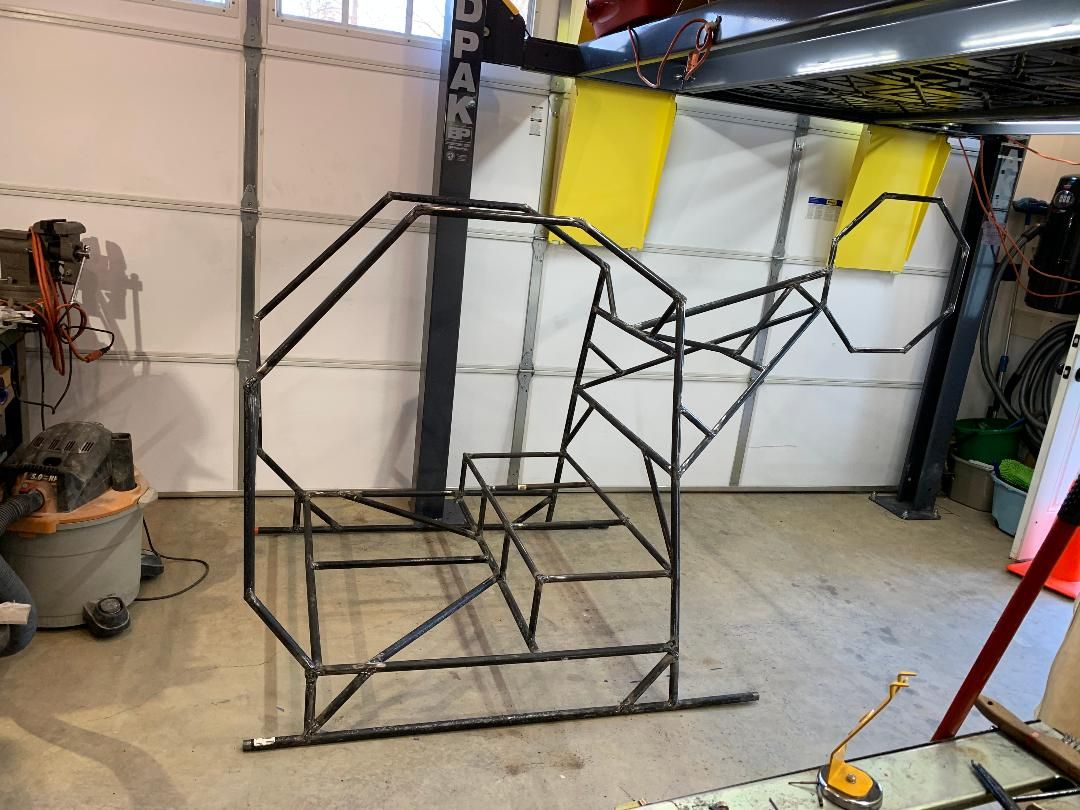

    i am building this for the grand kids, it will have running lights, a swivel spot light, potentiometers that move the gauges and switches that control lights, a tractor or motorcyle battery and solar panel, a "rescue basket" and problay painted orange and white for USCG colors

    What are you welding it with? Cool project but the welds look suspect.
  4. Likes rhunt liked this post
  5. #4
    Dec 2005
    arlington va
    359
    Re: metal pipe play helicopter
    welds are ugly for sure......1/8 and 1/16 E6013, i have some 5/64 coming in a day or two.
    I have gotten so spoiled my by MIG welding I havent touched stick welding in over 20 years. so i figured i would force myself to use the stick welder for this project and just keeping adding metal to the ugly spots. its strong as hell but corresponding ugly. any horizontal straight line welds looks really pretty, going around the tubing is less then desirable, its strong but really ugly, I figured I would just keep stick welding and do grinding to clean it up and if i need to clean up any areas either TIG weld it or MIG weld it.
    I will admit I am having fun stick welding even though its not very pretty.

    Any stick, on pipe this small is 'last choice' - as noted, your product is
    poor - and will do 'next to nothing' to advance your welding skills.
    Dressing [grinding] on pipe joints this small only makes things uglier.
    With proper joinery and MIG - it could have looked cast . . .
    Conversely - big kudos for original design - for the Kiddies - at an age
    when they will keep the memory of their Grandfather for life . . .
    hth

    interesting observation, I knew I could do it with the MIG and it would look really good and be pretty fast, TIG would just take too long.
    I didnt realize that the stick welding was the last choice ( to start with) but I can tell you I certainly am living that observation and reality at this point. it was an effort getting good fitments of the tubes to each other. I look at these fun projects as just challenges to push my abilities and to learn new things, after all it just a kids toy to play in. thanks for the observations, bob

    Stick should be fine. No need to use 5/64. Isn't that stuff 1/8 thick? I would do 6011 at 3/32. Aside from pilot error, perhaps metal quality is an issue? I just think 6011 is more forgiving at different amperages. 6013 needs to be dialed in a bit closer to keep slag holidays to a minimum.
    However, 6013 would run nice and clean if you can figure it out.
    Not sure how much slower TIG would be given the cleanup required after stick.

    thanks for the input i appreciate it , I just looked at the rods I was using they were 3/32 not 1/8 (sorry i got that wrong before). I did try the 3/32 6011 thinking it might be a better choice and it was really "jumpy" on me and i could not get it started as easily as the 6013
    the thickness of 1/2 sch40 is .109 and the 3/4 sch40 is .113
    the biggest problem I had was with the 1/2 pipe to the 3/4 pipe connections, and I am sure its a combination of my skills on every level....and maybe less then the highest quality product, but lets blame my stick skills first. I dont get too stressed about these things its not like its a show car....and its just for fun.
    I dont intend to do much clean up on it just a quick hit with a flap wheel to make sure its somewhat smooth. the 3/4 pipe was much easier to weld then the 1/2.
    the next warm day i get i will clean it up and perhaps do some nice 1" long horizontal beads on the joints to make it look prettier. I can do those nice and pretty its following the tubing around the circumference that is challenging for me.

    Welds are a tad rough. 6013 is a bugger if cold. Looks like black pipe. Suggest cleaning the coating and dusting to bare metal. Run 6013 to about 130 A and do more of a button weld on one or two sides since flight strength is not critical. It will weld just fine.

    thanks its 3/4 and 1/2 black pipe. now that i have no gaps on any of my joints the 1/8 is working well to clean up the ugly build ups i had to do. i should have built up the open gaps more before I tried to bridge them. and yes i discovered the shorter beads work really well. thanks bob

    For what you are doing - this weld standard is fine. Your pipe appears
    to be 'coated' . . . ?
    Black Iron Pipe is available - coated, and uncoated - the coated has a
    quasi-saccharine smell when welded, and visibly burns.
    The coating is a rust preventive - and doesn't take paint well unless
    blasted.
    When buying from a 'Real Steel Yard' - coated is usually the default
    issue - you have to specify uncoated when ordering.
    If you buy from 'The Big Box' or a retail plumbing supplier - coated is
    probably their only offering . . .

    Hell............it's tough to weld that thin stuff with stick. It's a prime candidate for flux core wire. Or MIG.

    I can say I'm the greatest welder on the planet, but I know damn sure I'd blow through that thin stuff with stick. Is what it is, and I can only do as good as I'm capable of.
    Just a note..............6013 is said to be a low penetration rod...........which would make it seem to be a good rod for thin stuff..........but the heat input is the same as any other rod, and it will burn through..........plus it tends to leave slag pockets if you're not familiar with it. I'd venture a guess that you'd be better with a fast freeze rod like 5P Plus, or equivalent.

    thanks guys, a couple of the pieces of pipe did have a glossy finish to it, others did not.
    as I look back on it, I can see my biggest problem was caused by poor fitting joints, that i tried to bridge at first. Once I figured that out. I built up gap areas and then had success and started having nice looking welds again.
    I can bridge gaps easily with my MIG (w/gas) but wanted to renew my stick skills, in retrospect this was probably not the best project to accomplish this. but then I relearned alot that I forgotten so maybe it was the perfect project. so now i have to figure how i am going to treat the weld areas prior to painting....two approaches come to mind one paint them with seam sealer the other is to use fiberglass body filler on them. any other approaches? thanks bob
