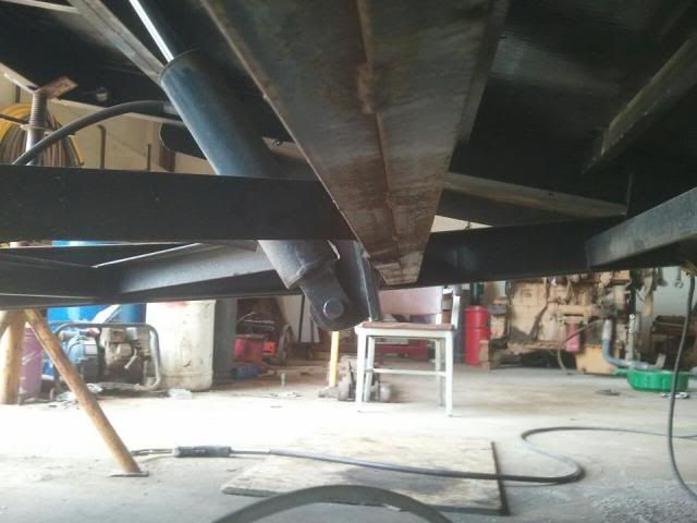

This is a factory made hydraulic tilt trailer we are working on as a side project. This trailer is practically new, tandem Dexter 7K torsion axles, 2 5/16" hitch. Supposedly rated for 14,000 pounds.The problem is, when it is tilted to load, an immense amount of force is exerted on the bottom cylinder mounting bracket. As you can see in the picture, the pin of the cylinder where it is mounted is about 4" below the crossmember it is welded to. This crossmember is two pieces of channel somewhat welded together to create a type of box tube. Both of the angle iron braces have been broken out at the weld. Also, where the channel of the main frame is bent to form the tongue, they cut the top and bottom flange of the channel, bent it to form the tongue, and didn't even weld the flanges back together. The passenger side of the frame had a crack about 1/3 of the way up from the bottom, the driver side had broken completely in two.

No, it had no fish plate at the bends. This side was broke completely in two. The owner had scabbed a 2"x6" piece of 1/8" onto it over the break to pull it to us. Supposedly it broke the first time he hauled his tractor on it. I don't know how big the tractor is, but the new brush hog for the tractor was sitting on the trailer when he dropped it off, and it's a 5' brush hog I think. So I can't imagine the tractor being bigger than a 8n or 9n ford. Nowhere near what they advertise this trailer being rated for.
#3 ·
At this point, we have ground out the cracks, welded uphill with 7018, ground smooth and fishplated with 1/2" plate about 12" both ways from bend/cracks. We'd like to plate the inside also, but the crossmember there kind of makes that difficult. My opinion, the frame/tongue should have been made out of heavier channel to start with. When the trailer is tilted, the force on this part of the frame is a lot. Another design flaw I see, is when the trailer is tilted, the front tires are lifted completely off the ground. This isn't just a car hauler trailer, it's advertised for hauling tractors also.
As far as the leverage problem with the cylinder, what we've come up with so far is a piece of heavy square tubing, as a crossmember right in front of the smaller channel crossmember, behind the cylinder, with a square tubing stiff leg from it to the cylinder mounting plate. Does anyone see a better idea?

Is there no room for a cross member aft of the lower cylinder mounting cross member? I'm thinking if there is one behind you could and a cross brace (tubing) from the bottom of the cylinder mount back to the new brace. essentially transferring the force from the cylinder mount back to the next cross member.
#9 ·
That's exactly what's being done now. A new cross member directly in front of the smaller cross member behind the cylinder. 4"x4"x3/8" square tubing. Then another piece of it running from it to the cylinder mount. I really don't know any other way to "fix" what is there without basically starting over on the cylinder mounting. The manufacturers idea was to brace the cross member the cylinder is mounted to with the angle iron in front of it. It just pulled weld and all out of their cross member. It looks to be built heavy, but the 6" channel that the tongue is made out of MIGHT be 3/16" thick.

The main problem is that your cylinder is in a bind. Ok, not actually a true bind, but a bind none the less. It has to exert a huge amount of force forward before it overcomes the angle and starts to straighten out to actually do a lift.
If you have the room on the frame, and can sacrifice some ground clearance, I'd move the cylinder forward, and down a bit.
If you don't have room etc. , try going above the deck ;) Move the cylincer forward a bit, and then put the upper pin actually above the deck if possible. House it in a little dog house sorta. It would be centered, and on the forward part of the deck, so shouldn't interfere with any wheeled thingy you might load on the trailer. The higher the doghouse the less you'd have to depend on that stupid lower eye tab they've done, it's nothing but a lever trying to twist the "tube". Closer you get to the center of a tube, the stronger it is as far as resisting twist.
You have to straighten the cylinder motion or continue to tear up the trailer every time you activate the hydraulics.

You're also having a moment on the frame channel.
The channel can be reinforced by adding more beef to the lower flange. You get the most bang for your buck by reinforcing the flange in tension as opposed to the flange in compression.
