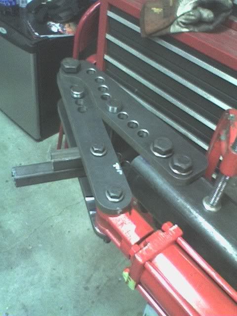

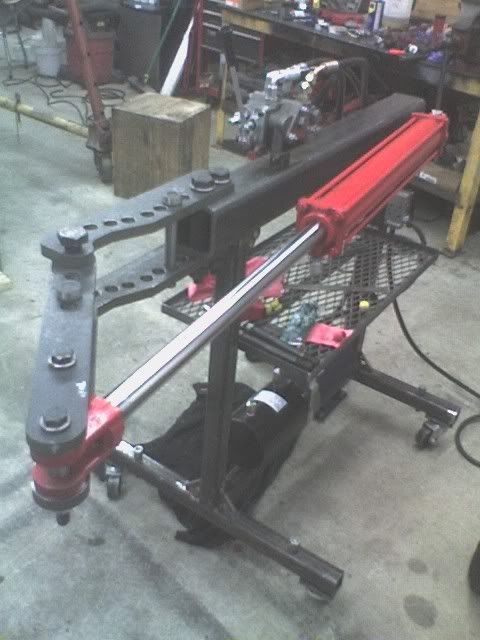

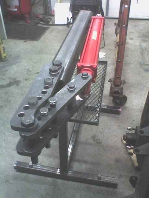

Hello again,
It's been some time since I have made it back to the
forums. One such project that I've spent some time
on has been a hydraulic tubing bender. After browsing
these and other fabrication forums online I decided to
begin building one for my own garage. The main bender
arms were cut from .75" MS flat bar using an AWJ and
the main beam was selected from 4"x4"x.375"
rectangular MS. The cylinder is 3"x24"@2000psi.
The uprights of the bender were built from heavy wall
2" rectangular MS. Everything was joined using Precision TIG 225.
Pics attached.
#5 ·
Minus the 1-5/8" and 1" dies, between the steel, cylinder, pump, hoses and valve
approx 700. As far as plans go, I built the uprights and beam just from some pictures
I came across. Looking back I could have gotten away with 1/2" arms
and lighter rectangular tubing but I did not want a problem with it. The bender arms
I found and modified from this site. Thanks.
#8 · (Edited)
That was an ebay find. The lines I had made once
I knew the distances from the pump to the valve and cylinder.
very nice!!! I just got the air to hydraulic set up on mine but would luv to get a set up like that one day
I decided to build my own after constantly using a friend's. This setup works
great. I can achieve about a 120 degree bend (without retooling) in approx a minute, depending on
the amount I let through the valve. Only issue I have is keeping the follower/die
sufficiently lubricated which is why I bend at a slower, more controlled rate.
Good luck and thanks.
