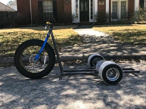

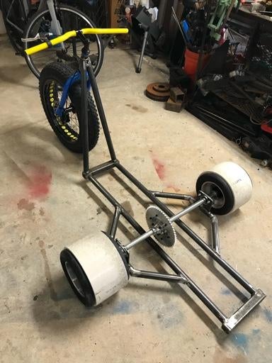

    Update on the trike. She’s a rolling chassis now. Got some hiccups with the throttle and parts we’re working through and waiting for the seat to come in.

    interesting
    What size engine?
    Looks cool but I’m not sure if I would trust the two rails going up to the fork neck.
    Eventually it will crack or bust off.
    Maybe you can weld a couple gussets in there

    We’re starting with a Predator 212cc 6.5hp. Depending on how it runs, we may add a Stage 1 kit and regear it. We’ll keep an eye on all the welds. It’s built from 1/8” material, so it is pretty rigid. It’ll run only on pavement, so I am hoping there won’t be much stress on the joints.

    I think John might have a valid point. You might try standing on the frame, and observing the deflection in the steel that connects to the fork neck. I'm sure it's pretty meaningful. The length of the two vertical pieces is pretty extreme.
    It's not so much about the welding, or the fatigue factor affecting the welds themselves. It's more about the fatigue acting on the steel adjacent to the welds. Any good filler material with good mechanical properties ought to handle the stress...........it's the parent metal that comes into question.

    Nice project Why is the axle moved forward so far? You have less stability in a drift with a short wheelbase. Especially if you're sitting over the top of the axle, you're upsetting the weight distribution a long way.
    It'll be a lot of fun no matter what, though.

    We spent about an hour riding it by standing on the frame rails and pushing it like a scooter. No issues so far, but I’ll keep an eye on it. The frame is still parallel to the ground as it was before we rode it. I’m 180 and one of my boys is 190. I will probably add gussets to the joints where the down tubes meet the frame, just to make sure. We’ve put a lot of work into it, so might as well make sure it lasts.
    The rear axle looks really far forward, but that’s only because the back of the frame is longer than necessary. Our wheelbase is right in line with what I’ve seen recommended. It tracks straight and seems stable with the live rear axle. It’ll be fun using the engine torque to snap the back end loose. The engine will sit behind the axle, but it’ll be closer than we thought, so the last 4” of frame will serve as a bumper.
    Here’s a vid of my son pushing it. We still have to do the foot pegs, seat, and engine plate before hooking up the engine.

    When I was a kid not many kids had a go-cart, the only error in design was my father used a plastic wheel from an erector set. Upon drifting an excessive amount on a slightly sloped dew-soaked grassy area of my grandfather's yard and crashing into a tree I realized that the plastic does not hold up. My chest took the impact of the shaft and nut that held the plastic steering wheel, it left marks. I suggest looking at the effect of the inevitable crash before it happens. But it looks great.

    Re: Show us what you welded today
    Quote Originally Posted by William McCormick View Post
    Sincerely,
    William McCormick
    Those tires are just wrapped with plastic piping. If the piping wears out you are left with the grippy rubber tires inside the pipe sleeves. This is done specifically for drifting.
    Lincoln, ESAB, Thermal Dynamics, Victor, Miller, Dewalt, Makita, Kalamzoo. Hand tools, power tools, welding and cutting tools.
