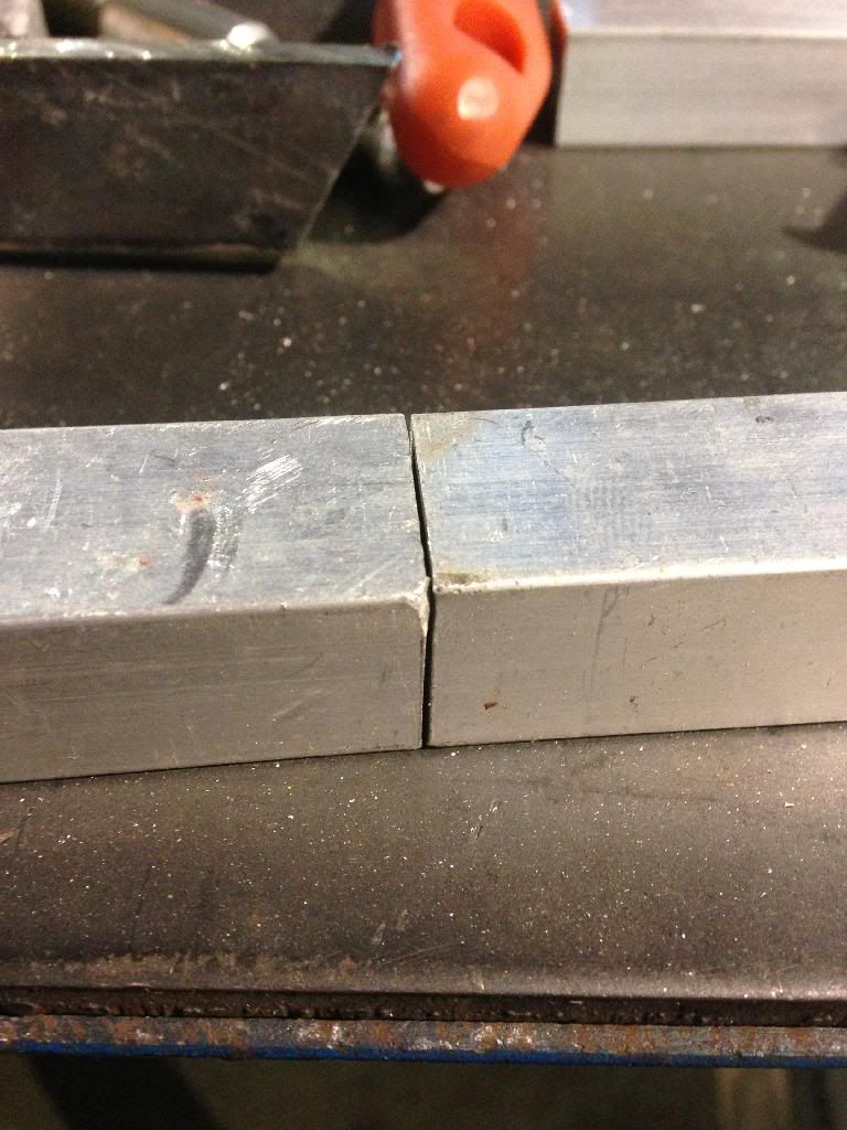

I'm building some enclosures that need to break down for easy transportation and can't find an easy way to make a "quick connect" or bolt connection where these tube ends meet. The material is 3/4 aluminum square tube 1/16 wall. I was hoping I could use 5/8 square stock to slip inside and weld to one end, then secure the other end with a nut and bolt. 5/8 is too big of course and I can't find 9/16 al stock anywhere. Can anyone suggest a method to secure these? It preferably needs to be inside the tube and not a sleeve.

Depending on what you are doing with it, and if it is one shot deal or constant use, take a hard grinding disk to the 5/8" solid on 2 sides. Won't take but a minute to size some short pieces for the joint. How many joints like this?
Put your location in your profile. Maybe a member close to you could mill it or something. Aluminum cuts a lot like wood, so you may run it through a table saw for long pieces.
#4 ·
You could skim that bar stock to size with a table saw and fence.
Since they need to be short I'd skim about a foot, pull back and rotate, skim, cut off a piece and repeat.
#8 · (Edited)
The round stock would be better than square for another reason. The round stock will place the point of contact in the center of the square tube faces, instead of the corners (which have a slight radius).
If you really need the very compact profile of the spring loaded locking pins afforded by the adorama kit, then you will need to go that route.
But, if you are just looking for a fast way to put up and knock down, you can use linch pins to secure the connectors. Linch pins have a spring loaded poppet ball that keeps the pin from falling out, and have a folding pull ring to remove the linch pin when knocking down. You should be able to cut your own connectors from round stock. If you have to buy a slightly larger diameter of round stock than the ID of your square tube, the same technique of table saw and fence can shave the round stock at 12, 3, 6, and 9 o'clock for a precision fit.
