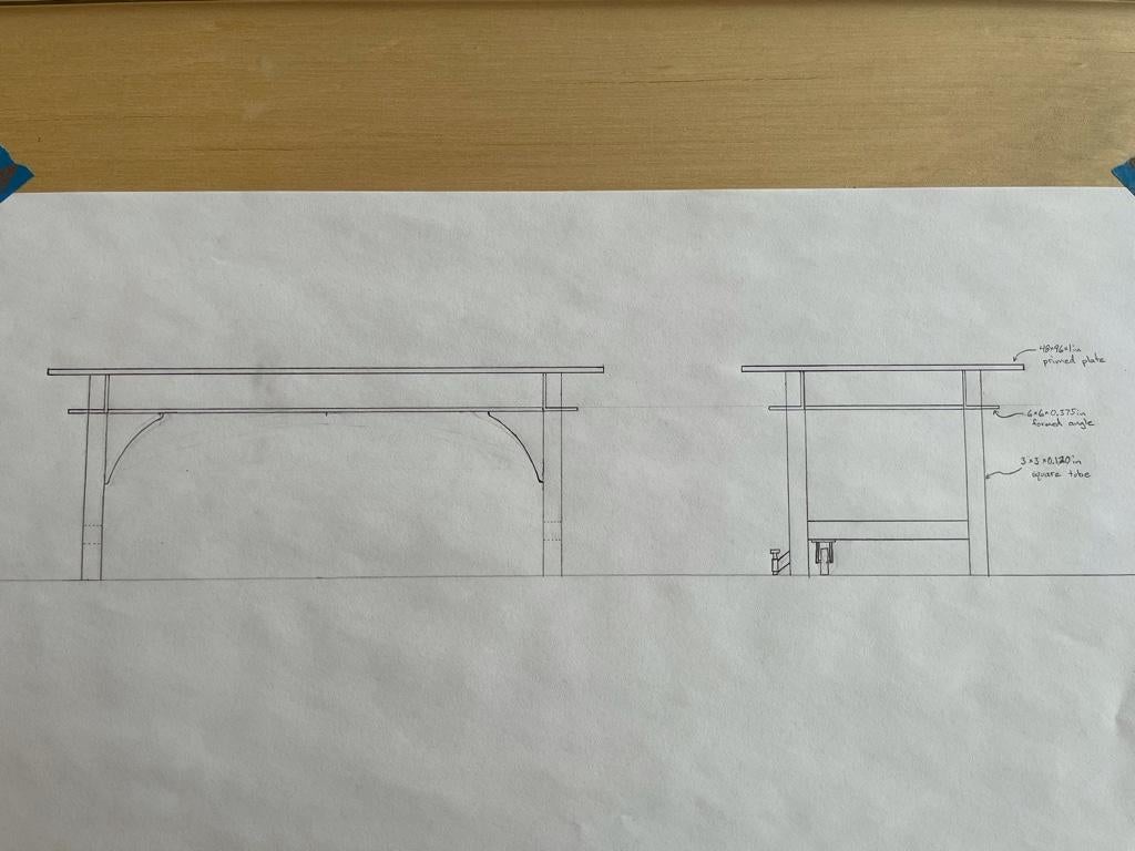

    I finally have some plate coming so time to build a welding table. I’ve been using the concrete floor, 2ftx2ft piece of 1/4in on a stand or my plywood out feed table - none of which are ideal. The top will be 48x96x1in primed steel. (I can also get pickled and oiled 1.125in plate but it’s $400 more.)
    I’m planning to do the rest out of stuff I already have on hand. I picked up some 6x6x3/8 formed angle I was going to use for the frame and 3x3x0.120 square tube for the legs. I also have some 3x5x0.120 tube but it isn’t perfectly straight. Here’s the sketch:
    Thoughts? Suggestions?

    IMG]https://images.platforum.cloud/uploads/20210325/ea826ba5dfc0c95e519b199d52590c2c.jpg[/IMG]
    I like it. The arched braces give it a very strong Craftsman Style vibe.
    Sounds like you've got the undercarriage heavy enough to support the 1" plate that'll top it, so really it's just a matter of details. Lately, I've become a bit put off by welding tables with a lot of holes in them for fixturing. While I see it as a necessary thing for fabricators, I tend to be the odd job kinda guy and will use the same table for teardowns as well as welding. I'm always dropping small parts and can't imagine what a nightmare it'd be if my table had more openings in it for things to fall through!
    Looks like Lis2323 has a ton of neat ideas that might help flesh out your build. Tool placement and storage is my #1 problem, so I'm always looking for neat ways to help with it.

    Lis2323 does some awesome stuff, but I don’t think I’ll be cutting holes in the top for a vertical receiver quite yet!
    And I agree, the fixture tables are awesome but even though I’m calling this a “welding table” it’ll probably get used more for working on my lawn mower/motorcycle, wrapping presents, hot glue projects with the kids, etc. We’ll see how it works out.

    Quote Originally Posted by ccogg View Post
    ,,,48x96x1in primed steel...
    Why primed for paint? You will need to flap-disk the primer off anytime you tack something, and anytime even a small section of the plate is heated from welding on top of it you are going to have poisonous paint fumes coming off it, top and bottom.
    I would have suggested A36 hot rolled, low carbon steel. That's all you really need for a basic flat 4x8 ft welding table.

    Paint is easier to take off than pitted rust. The thin air brushing on mine is lasting longer than I thought it would, and most times it isn't even thick enough to affect the ground. You might find the same with the primer, although Mondo is right, you will smell it when you burn it.

    I was looking for regular hot rolled, but this is on the “surplus” list at my steel supplier and the price is better. (They also have a pickled and oiled plate 1.125in thick, but it costs 50% more.) It is A36 and my plan is to strip the top right away. Maybe the bottom, although hopefully it won’t get hot enough to burn???

    Any paint you leave on the bottom is just rust-inhibitor. I wouldn't worry about stripping it off except around where you're welding, and then I'd put it back once you've completed the welds. There's no chance you'll put enough heat into a 1" thick table top to impact the primer on the underside. Or, if you do, you'll at least have a good story to tell!
    I love a flat bench. No holes or slots means it's super easy to do anything that happens around the homestead, and when you do need to weld something up.... those magnetic clamps are the perfect solution. Way better than always dropping your marker or bolt through some pesky slot!

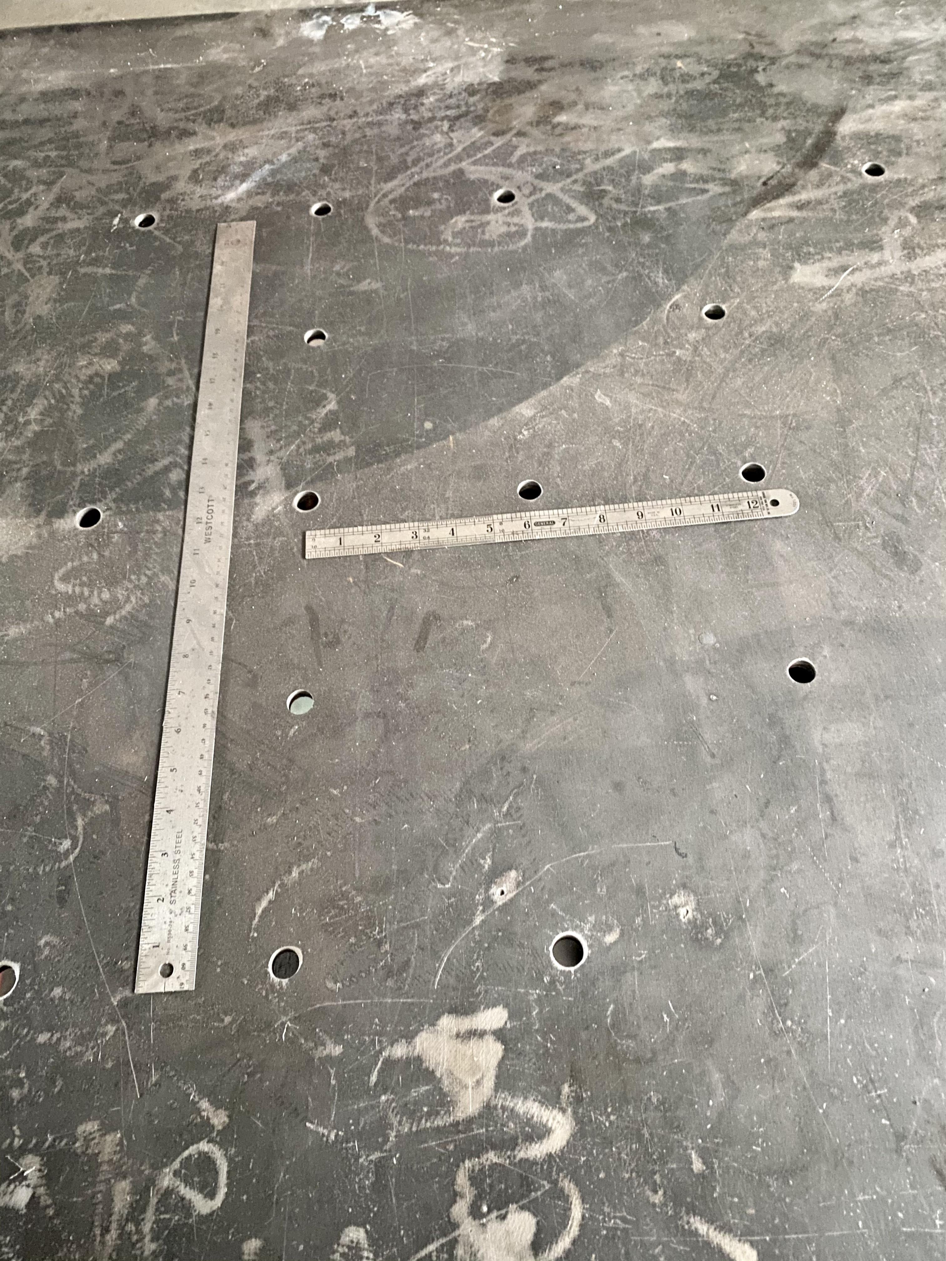

    Quote Originally Posted by VaughnT View Post
    . It's either a flat sheet of steel or a flat sheet with hundreds of holes, and nothing in between.
    Don’t forget my 4x8 table, Vaughn.
    I started out with twenty 5/8” round holes ( I didn’t have a mag drill at the time) and I’m at about 34 now.... plus a 2” x 2” square hole.
    I could imagine mine ending up similar to that. Did you layout the holes by hand?
    Yes. If you are only planning on a limited number of strategic holes I would suggest laying out and center punching marks on the perimeter of your tabletop for future referencing.
    I didn't think to do it at the time and it will make for easier accurate drilling locations if you decide to add holes.

    Yes. If you are only planning on a limited number of strategic holes I would suggest laying out and center punching marks on the perimeter of your tabletop for future referencing. I didn't think to do it at the time and it will make for easier accurate drilling locations if you decide to add holes.
    You can get around that by making a jig. Two pins welded into a flat bar on the correct spacing so the pins will drop into your table's holes. Then the rest of the bar's length is covered with 5/8" holes equal to the spacing of the pins.
    Drop your guide bar into the holes on your table and then drill through it's open holes and into the table top. Get one row done and move the guide bar to the next line.
    Might have better coverage and flexibility with removable pins that can be relocated in the guide bar. A transfer punch should be used for location or a drill guide inserted into the bars’s holes.
    Actually a guide bar may not be practical for a large table. By the time you lay out and accurately drill holes on an 8 foot guide bar you may as well just layout on the table itself.
