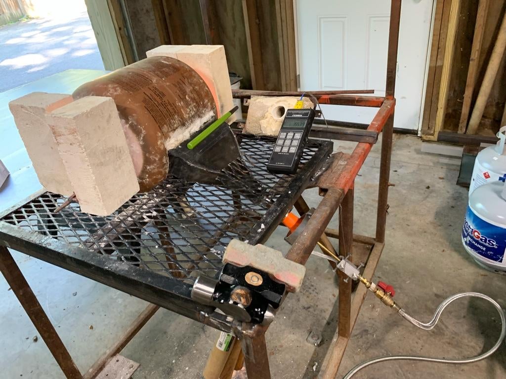

    I use a venturi ribbon burner of my own design. It works well.

    That looks impressive

    Got my interest.... more details on the construction/operation? How is it on fuel consumption?
    I 3D printed a mold and poured refractory to make the nozzle, then burned out the plastic. It worked really well and was my first try at that approach. It’s a nominal 3/4” size burner using a MIG tip jet. It does use a good bit of fuel, but I don’t have a reference. It’s 8”x2.5” so a pretty large area for the flame. I run at about 5-10psi for forging. I have very little experience and haven’t tried forge welding.
    I made the sheet metal plenum to let the flow from the mixing tube expand gently. All that seems to work pretty well. I may make a smaller version next. Thanks for the positive comments.

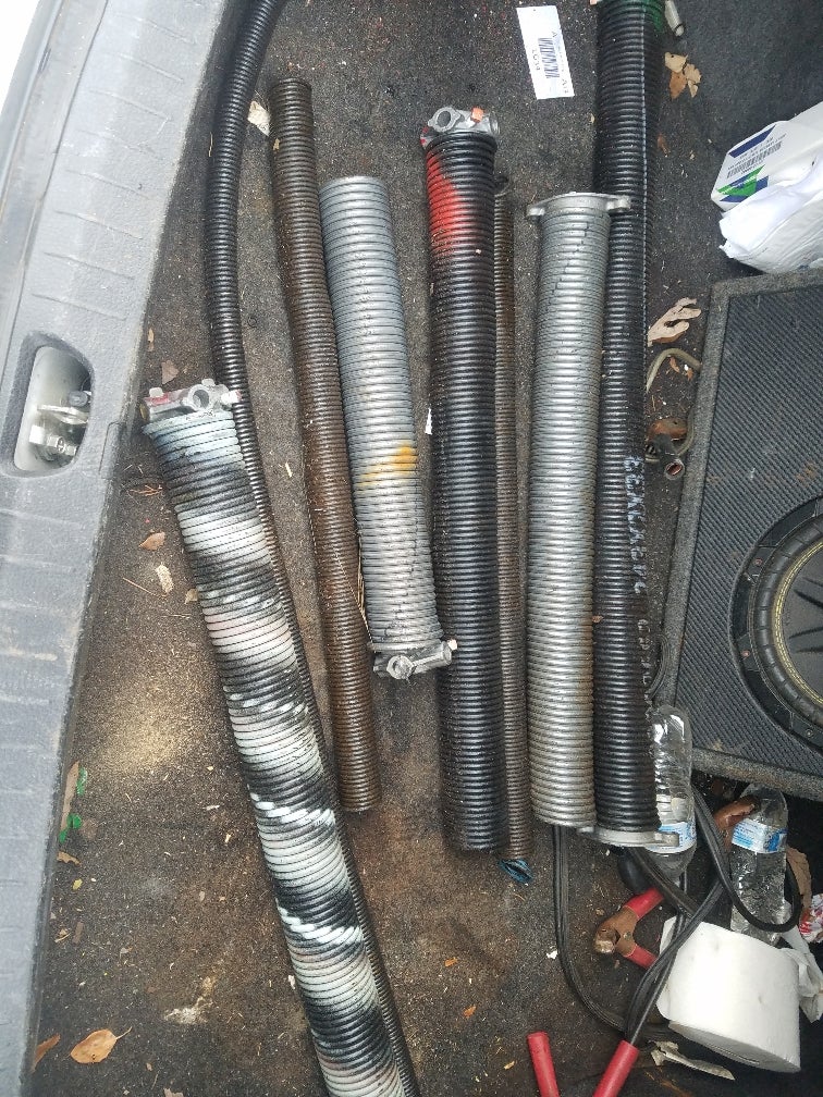

    I stopped by my local Overhead Garage Door office and asked if theyhad any broken, cut, damaged door springs.
    The guy let me climb in his dumpster and grab these. When I tried to pay, he wouldn't let me.
    There are three sizes here. I really wanted some of the 4 inch springs but he didn't have any. The steel can be used for a variety of small tools.
    You can use some sizes as quick hammer holder rings.
    The rings are also a quick and simple way to make large chains, chain mail, rain chains, etc. Plus I also like to use them in some of my other projects.
    I walked with my wallet out, explained I am teaching myself blacksmithing, and am not a meth head looking for scrap to sell.

    Those garage door springs look so cute and innocent when they’re not wound up on their torsion bars!
    BTW, Pat you would be welcome in my shop.... open wallet or not

    Funny that you mention curtain rings. I literally just got an email from someone asking about curtain rings after I read your post!
    Of course, I don't have a single coil spring that'd work, and she's wanting "mass-produced in china" prices, so I don't think I have to worry about them.

    I stopped by another door shop at lunch.
    There are some 4 inch and 6 to 7 inch diameter springs that might be available. Their tech is going to change the old ones out and they will contact me when they have the old ones. Those large diameter 6 to 7 inch springs are probably 3/8" thick.
    The second place had another small size spring. So that makes four sizes now. She would not accept money either. I gave her my business card as well.
