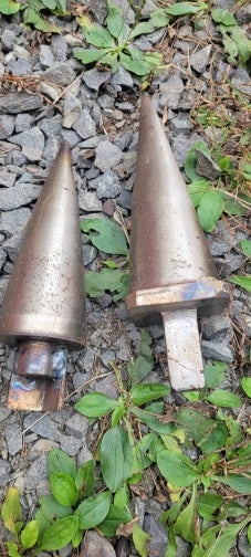

    Here they are

    Virginia, USA
    11,001
    Re: Blacksmithing and forging
    Quote Originally Posted by psacustomcreations View Post
    Here they are
    Sent from my SM-G996U using Tapatalk
    Those turned out great!

  15. #1935
    1,922
    Quote Originally Posted by 52 Ford View Post
    I wonder how much it'd cost to get a horn cast out of steel...
    Holland anvil already sells them. Grey cast iron, with tong groove and 1" square stem. Very nice bit of work for the money. IIRC, they run around $50+s/h. Got one in the shop and use it pretty regularly.
    You can't have too many cones, imo. While I like the Holland version, I would like to get a shorter one because it puts the impact down closer to the anvil when you're working on it. At something like 10" tall, when you're doing a small curl on the Holland cone, that puts the hammer work way up high at the tip of the cone.
    Not the end of the world, but a good excuse to buy or make yet another tool.....
