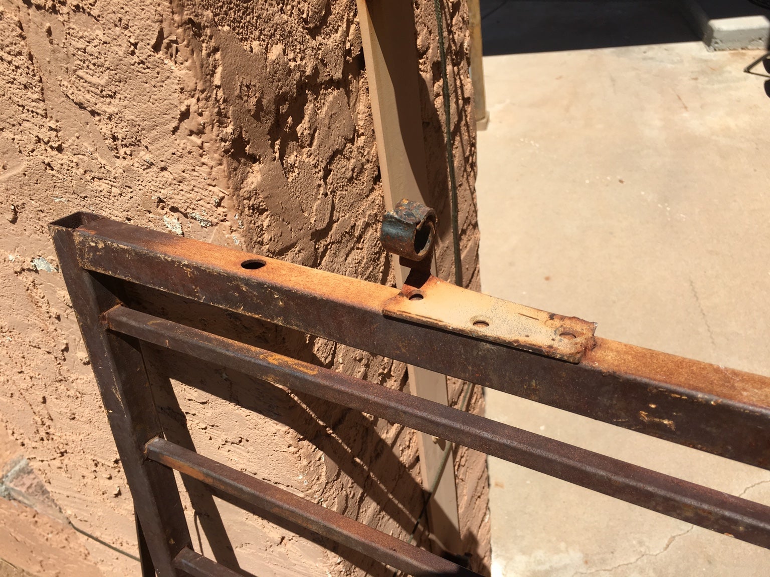

So, I'm at best a hobby welder learning to use my tools...

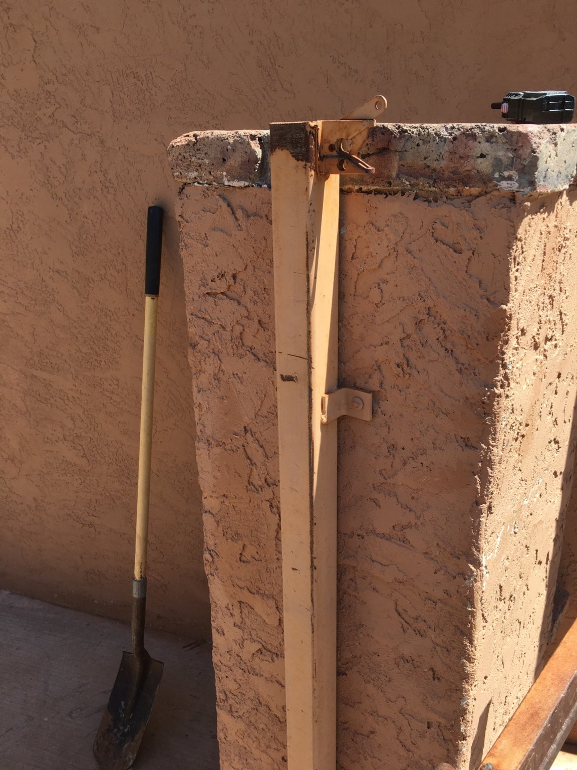

I've got this gate that used to hang between two block columns at the side of hour house. The previous home owner had welded (badly) some hinges onto some 1/8" strap on one side, and had the match on a reused fence post on the other (see pics).

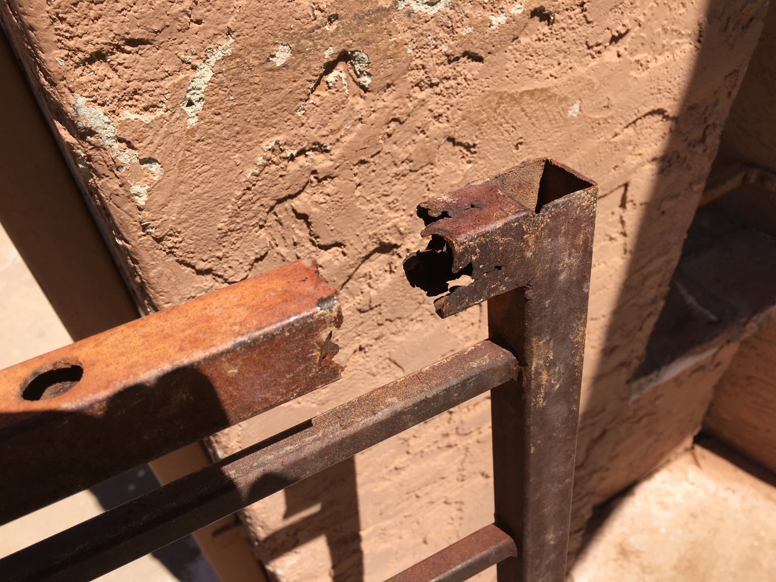

Question 1) I have some 1" tube I'm going to use to replace the rusted out section of tubing, but not enough to replace the whole length (ideal). Any tips on the best technique to replace just this 4-5" section?
2) I'm looking for guidance on where to find self-closing gate hinges that can be reliably attached(welded or otherwise) to the 1/8" strap side.
I'll be grinding off and cleaning up the existing hinge cruft, so I'm pretty open to solutions.

So worked out the repair tonight. Picked up a short piece of angle and welded it inside the patch section:
Then I'll fit that inside the existing (cut back and ground down for welding) tubing and weld it all tight.

Splices are always a challenge. Sometimes you get lucky and they look ok but with square tubing it's hard. I usually clamp a straight piece of scrap that will span the length of the splice to help line everything up. The grinding is the hardest part due to the radius on the corners of the tubing. Go slow and make light passes with a flap disc and then finish off with some 80 grit sandpaper with a wood block backing it up. Try to follow the radius of the tubing to help smooth everything out. If you have a orbital palm sander that will work even better.
I blended these using a 40 grit flapdisc then a 2 inch 60 grit pad on a right angle die grinder and then finished off with orbital palm sander. Always following the radius of the tubing
