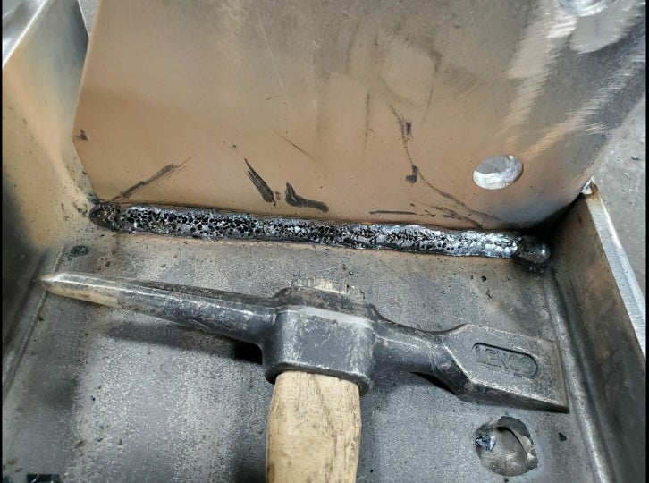

    I placed three sheets of plywood for wind control It won't fit in the garage. Doors are 8' tall, hoe is at least 8'9" tall. 26' bays. hoe is 30+ long. With enough effort I can extend the hoe to the back wall where there would be less air current. I haven't tried that yet.
    Today it was plywood wind screens, and more shielding gas, being diligent about CTWD.
    No improvement today.
    This project has taken too long! My customers & my wife are demanding an end. MIG is doing the job. Dual shield is wasting time.
    A friend & customer was pressing for us to do a three day earth moving project. I jumped the gun on the thumb build & went to work with a brace not yet there. I reasoned it was plenty strong without, I'd be careful.
    It bent. First order of business today was straightening the 1X4 11" long the hydraulic cylinder acts on. I built a box to use a 20 ton hydraulic jack to push it back to shape. Didn't want excess weld I'd then have to grind off. First weld to break at 40000 lbs was non eventful.
    The mess you see in pictures is the first broken weld repaired in a not pretty way. Ultimately two other welds failed simultaneously in an explosive manner.
Size:  152.3 KBName:  Worm2.jpg
Size:  112.6 KBName:  Worm3.jpg
    Dual shield with plywood wind screens. 50 CFH Argon 75/CO2 25. Lincoln Ultra core. .045" My regulator won't go higher.
    Barely perceptible wind. If i dropped a dry leaf it'd land a foot vertically from where it was dropped.

    hat specific UltraCore? There are different variations and not all use mixed gas.

    Try a new spool of wire. I have ran out of gas while welding and it wasn't anywhere near that bad before I realized I was running out.

    I find dual shield fairly forgiving, the way those beads look it seems like you have a major issue like bad gas or wire, more than just a technique of CFH issue. Check out this beautiful turd I laid down when I forgot to open my gas. So thats's with NO shielding gas at all, yours look almost as bad.
    Thats with Lincoln wire as well. 71Supreme .
    Sent from my SM-G970W using Tapatalk
  14. #39
    182
    Worm tracks
    I don’t know what your prep is like, but I have experienced similar porosity with Esab Dual Shield 70 Ultra Plus. In my case it’s almost always contaminants....traces of grease, paint, rust, plasma cutter dross,etc. IME, dual shield is less tolerant of contaminants than solid wire mig.
    I stand to get flamed for this, but I sometimes find that foreword/back manipulation of the puddle helps in the case of contamination. Run ahead 1/4” to get the crap boiling out, then fall back and dwell in the puddle to fill out any pockets left behind, then run ahead again.... Also, it seems constant oscillation helps to encourage the contaminants to float out - don’t stay straight and steady like you normally would with dual shield. Not in line with approved procedures I’m sure, but it seems to help.
    Edit....looking back at your pictures, I’m even more convinced that your culprit could be rust/paint/grease/water. Is this possible?

    Those are very bad as in, not just worm tracks, there is porosity. Like someone else mentioned, there are lots of Lincoln Ultra-core's.
    Have you every successfully welded with this exact roll using C25?
    If you look HERE, some Lincoln Ultracore wires use only 100% CO2. Which exact Ultra Core are you using?
    1st on WeldingWeb to have a scrolling sig!
    I've used it a few times. I limit it to heavy steel welded out of position. The roll is a couple years old. I built a skidding arch for the bulldozer. I did have a few spots I had to grind out when it got breezy while welding. That was mostly 1" thick stock.
    I rebuilt a backhoe bucket a year ago with no troubles.
    It is stored upstairs in a plastic bag when not in use. The second floor of the garage is HOT in summer, and a bit warmer than outdoor in winter.

    So again to reiterate, which ultra core are you using exactly?
    Not much information. I take it to mean 71......85000 tensile.
    Hot in summer? in a heavy plastic bag that has already been opened and resealed without any moisture eaters? I'm almost betting that is the equivalent of "steaming" moisture into that wire. I don't know the whole story, but it kinda makes sense to me. Your mileage may vary, but i think you need to try some new wire to be sure.
    I don't know. Seems a logical theory.
    KD welding is the local heavy user of this product. He is severely overworked. Though he'd probably make time to help sort out my problem, I'd feel very guilty asking.

    I see. Just wanted to make sure that wire was indeed compatible with mixed shielding gas.
    Quote Originally Posted by Willie B View Post
    I did try a simple bead on the horizontal, it was flawless.
    So you said with this exact wire, just before you got worm tracks/porosity, you were able to lay down a horizontal bead with zero issues? Or was that some time ago and not during this time-frame?

    Is there any way you can bake that wire? I know you probably don't want to just chuck it, but those welds ain't gonna cut it.

    I agree that storing for 2 years in varying temperatures likely introduced moisture into the flux. Wire might not be rusty because Lincoln puts a graphite coating on the wire. Maybe baking it for several hours would help but that might be hard to do with a fibreboard spool. Should work fine with C-25 shielding gas. How clean was the steel you were welding? Could be a combination of things contributing to the worm tracks and porosity. See page L13 of the 2nd link concerning storage conditions. I suspect your wire is contaminated from improper storage. Keep the unused wire in the house where the temperature is more consistent. Dual-Shield isn't the best option for occasional welding where it takes month's to use up a spool.
    https://www.lincolnelectric.com/asse...1A85/c3126.pdf
    https://www.lincolnelectric.com/asse...ure/mc1578.pdf
    https://www.dryrod.com/technical-art...lux-cored-wire
    Same day. Nasty worm tracks & porosity, I tried a simple bead on a piece of 1" thick flat. While it wasn't hot enough, it laid down flawlessly. Conditions were identical except position & no joint to fill.
    Been having issues with the wire bird nesting so I've thrown away maybe 50 feet of wire.
    It's on a pressed sawdust reel. At the pellet mill they heat pine sawdust to 600 degrees with nearly no oxygen present. I doubt I'd get away with that in Mrs. B's oven.
    I will find time to get it indoors, and try again. A new roll would be worth it if it solves the problem, or a waste of money if it doesn't.
