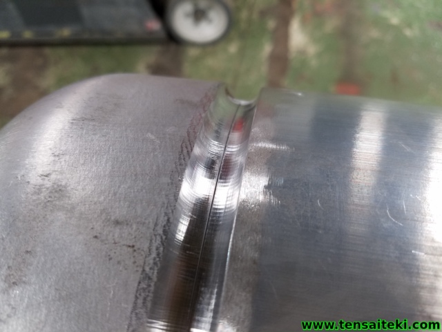

    The first part to be built is the oxidizer tank. This is a roughly 10 ft. long tank made from 8" Sch. 40 6061 aluminum pipe with forged 6061 caps welded on. Since the oxidizer is liquid nitrous oxide the tank will have a working pressure of around 800 psi.

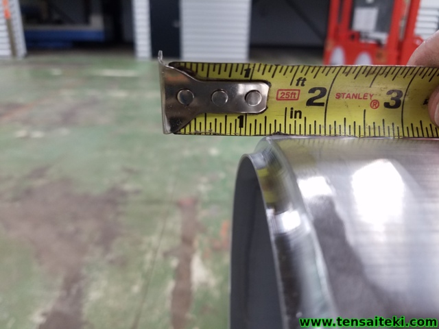

    If this were steel, the standard joint prep for joining the caps to the pipe would be a 60 degree V-groove with an open root. However, open roots and aluminum don't play nice, so a better joint design is to use a U-groove with not root opening.
    A U-groove prep would be very difficult to do by hand with a grinder and the pipe isn't quite round enough to be easily put on a lathe (even if we had a lathe that hold something nearly 10 ft. long).
    The great thing about 6061 aluminum is how easy it is to cut compared to steel. It can even be cut with wood working tools.

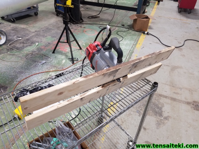

    The wall thickness of 8" Sch. 40 aluminum pipe is pretty close to 5/16". So a 1/4" radius cove bit with bearing in a wood router with a large enough base (added) can be run around the end of the pipe to produce half of a U-groove with a perfect 1/16" land.
    (Click on images for a larger version.)
    Here is the router I bolted some scrap wood onto to give it a large enough base to sit stably on the end of the pipe:
    Here is one end of the pipe with its half of the U-groove prep:

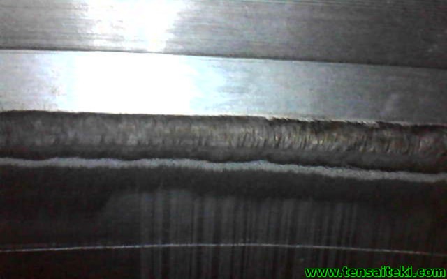

    The trick with getting full penetration on aluminum is to watch the puddle very carefully and always keep it right on the edge of falling trough and blowing a hole.
    I use a cheap USB borescope connected to my phone to get a view of the back of the weld to check for proper penetration/melt-through:
    In that image you can see the machined inner surface of the end cap at the top, the weld melt-through in the middle, and the extruded striations of the pipe at the bottom.

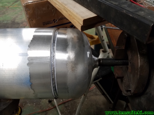

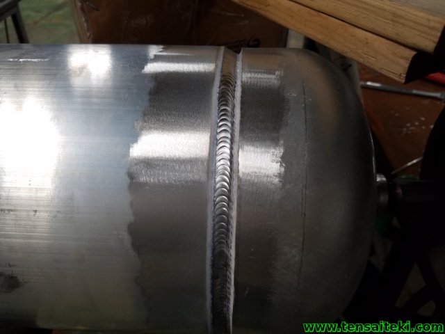

    Here is one of the hot-passes; you can also see the 3/4" pipe fitting that is welded to the center of the cap at each end as well as the barely-good-enough weld positioner that makes this sort of thing much easier:
    To minimize the size of the heat-affected-zone, the entire piece was allowed to cool to under 100 degrees F after each pass.
    One of the fill passes:

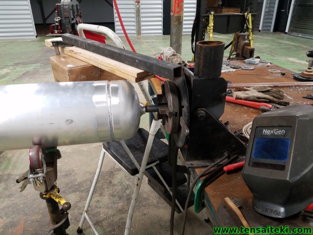

    Here is a shot of the positioner set-up. The stool, box, scrap wood, and random tube steel act as a steady rest for my torch hand while the piece of pipe on top of the positioner is a good elbow rest:

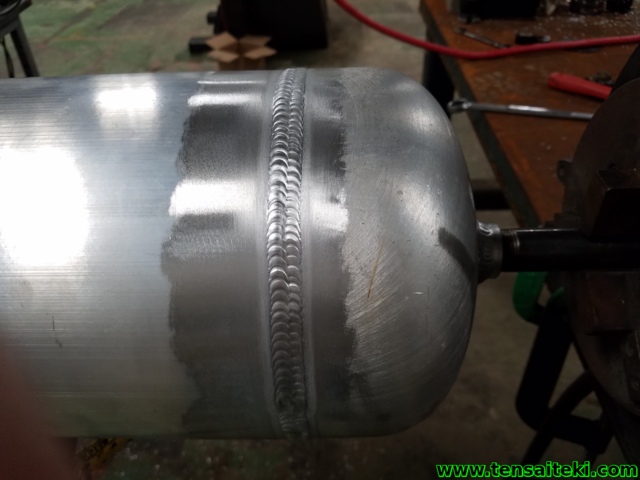

    Another fill pass followed by cooling:
    Here is the other end of the tank with the last fill pass before the cap passes:

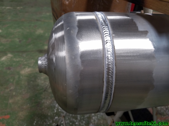

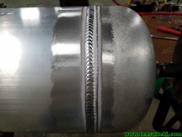

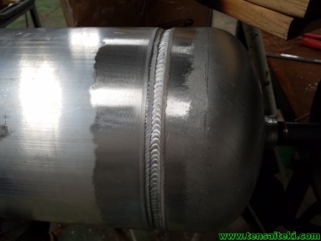

    Two-bead cap as-welded. Even with 75% DCEN balance, 280 amps of AC TIG leaves a substantial etched area next to the weld:
    After a light stainless steel brushing:

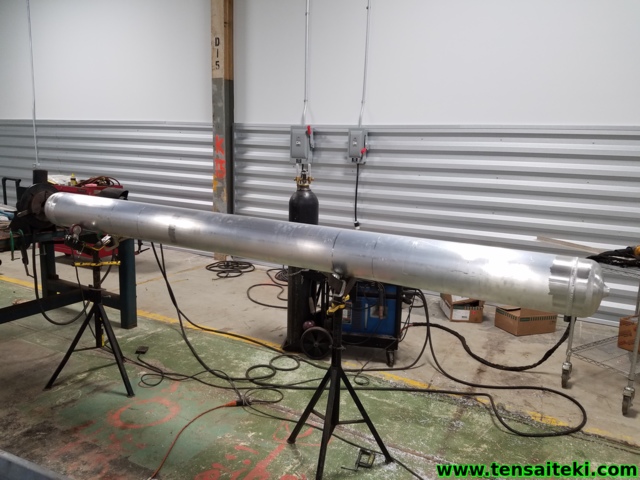

    Overview shot of the whole tank:
    Should to hold 800 psi, easy.
