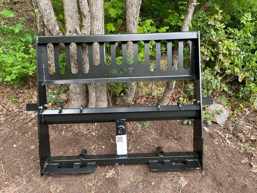

    They look better than the ones on my neighbors new skid steer forklift frame!

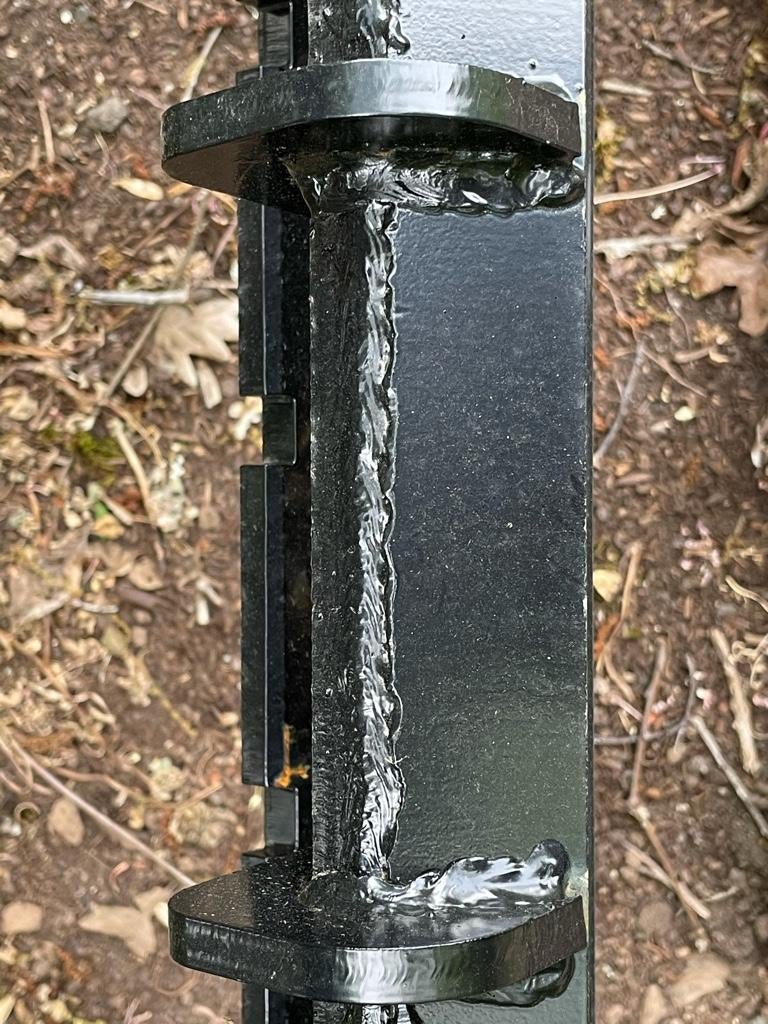

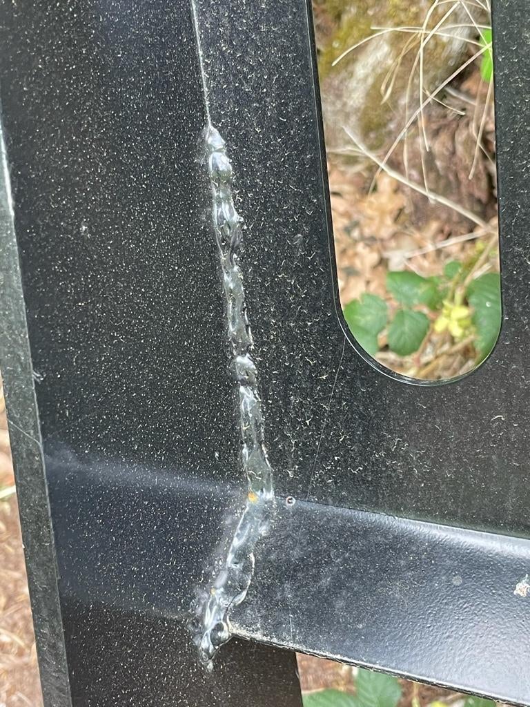

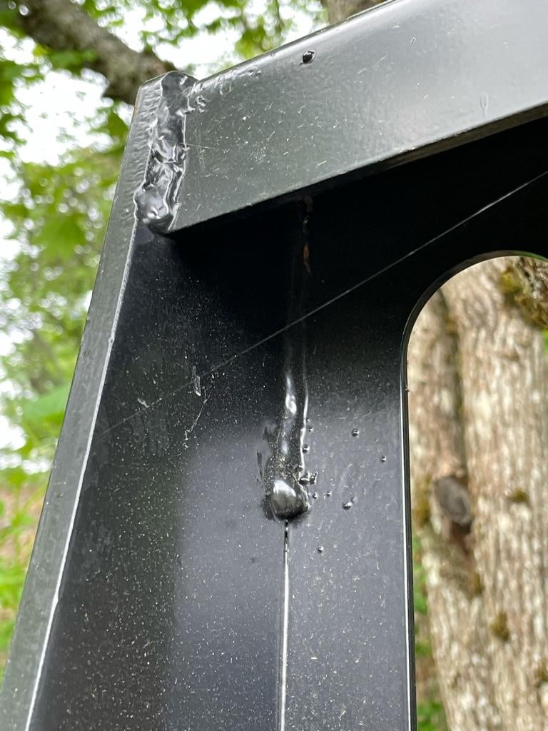

    That is a fine example of some Gorilla Welds. Strong but ugly.
    I don't think that frame will have any issues. You can see how the welds wet in to the base metal quite clearly. They might not be pretty welds, but I'm sure they will hold fine.

    I'll have to respectfully disagree, those may not be pretty, but they are goo
    d welds.

    Which welds are you taking about? The OP's I agree should be ground out and done by someone with more experience. The welds on the skid steer plate are ugly but have enough heat that they look to have fusion. TRAILERS, especially ones that will be pulled on public roads (as opposed to say a farm trailer) for some reason seem to be at the top of the list of builds for brand new beginner weldors. As pointed out some of the cross member welds look OK but need to remember MIG is famous for cold lap where the weld looks good but has very little FUSION into the base metal. Weld is usually good on one side and not the other.(This is the reason Lincoln was so late to get into MIG! They were working on Innershield self shielded wires) Another problem which may or may not be the problem is newbies buying too small of machine for the job. They want to learn to weld and see a deal on a 120 volt Mig/Flux-core and figure it will serve their purpose to learn welding. A course at a community college or even hiring an experienced welder for even a couple hours will cut the the learning curve way down. You can read all the books and watch all the video's but there is no substitute for arc time. Most (140 amp rated) 120 volt Mig are good for about 1/8" material and up to 3/16" with a more experienced weldor. Too many owners figure thay can get away with 1/4" cause it's only a little thcker. WRONG. Better to have more than you need and tern them down than try to push too small a machine. In an emergency 1/4" could be done if the base base metal was pre-heated to almost turning color. Not red hot but not far from it. Not really practical for any projects requiring more than a 2or 3 short welds.
