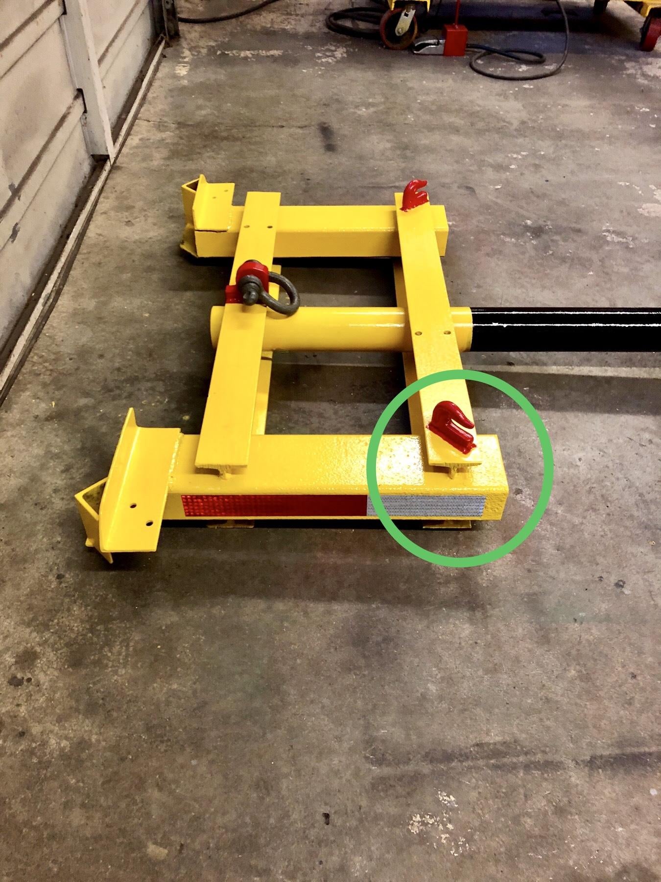

    Well, the loader bucket had a broken hook on one side from the previous owner, and I needed a guinea pig for the new-to -me Dialarc so this is where things went. I have never welded with DC before, so I started out with the Chinese 7018's that I didn't like at around 90 amps. No sticking, but they still need to be scratched on the concrete every time you start, so they were still annoying. I was just going to make a quick tack but that Miller just wanted to weld...
    The hook had been broken before, so I needed strength. At this point I switched back to the Eutectic rods and ran them at the max recommended 95 amps. Ran like butter and much easier to control than when I was running them hot for the loader arms.
    I needed to fill in some gaps between the shape of the hook and the base so I decided to try some bigger rod and got the 5/32 7014 out at 175 amps. Waaay too hot... it was like holding a bolt of lightning. Calmed things back to 145 and it worked good...
  2. #52
    14,981
    Re: CAT Loader Repair
    Finished hook isn't exactly the same shape as the other side, but it should work good if I don't abuse it too much.
    Finished product after grinding and paint.

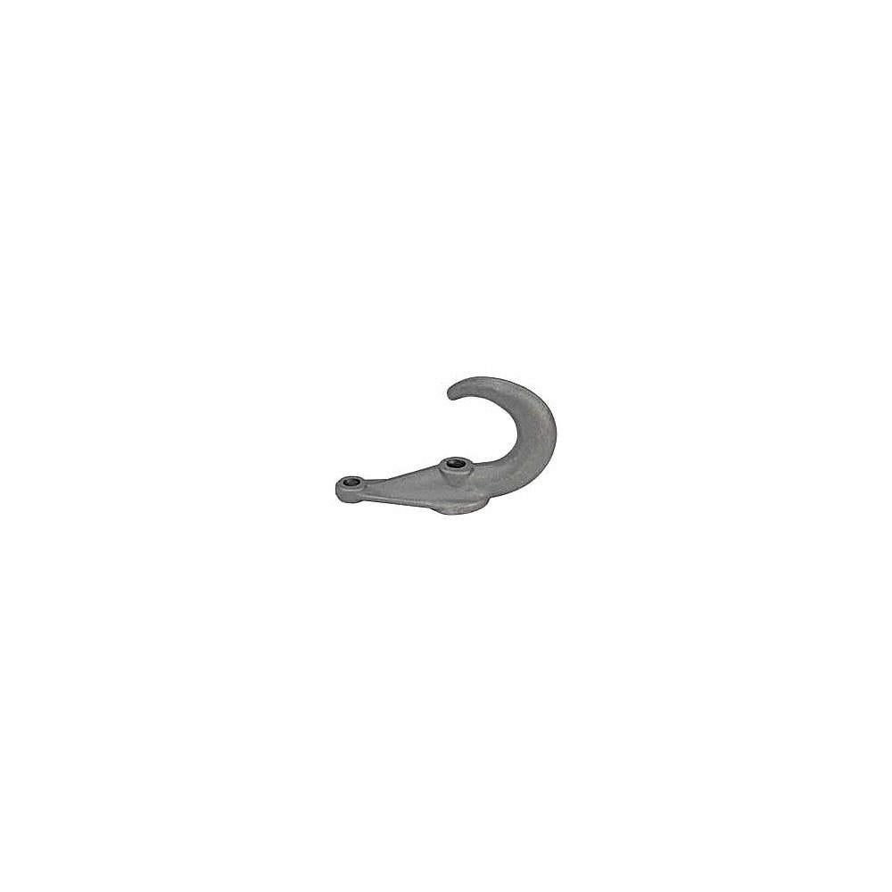

    That bolt on hook is a poor design and I wouldn't trust one that was welded. I'd get a proper weld on hook and weld it directly to the bucket. Here's a simple hook. There are are other styles too.
    https://www.northerntool.com/shop/to...8590_200658590
    I use those hooks. Princess Auto has them!
    When I look at the unpainted one, I kinda think that is not a hook,,
    it is more like a quick attach for some accessory, like a set of forks.
    BUT,, the rusty hook might just be so "sprung open" that it appears like it is not a hook,,,

    I would guess the previous owner welded a regular chain hook to the base of a broken TOW hook base.
    Maybe it was originally like this, designed for a truck frame..
  15. Likes 12V71 liked this post

    From what I've seen, that's the way CAT made them... it might be a little bent. I'm not worried, any heavy lifting I would run the chain through the loops on the back of the bucket like it is in the pic. The hooks are just to keep the chain from sliding off the end of the bucket.

    Yep, exactly what it was originally. I have broken those hooks... On a 10 ton M123 military truck... pulling a semi trailer with 50,000 lbs of drill steel... in deep mud... with a 12 cylinder D9L Cat. The hook and 1-1/2" cable choker scratched the paint on the ripper frame.

    I don't think broken hooks that could be used to lift anything should be welded by anybody. You lift 20 things no problem and forget about the hook, then the one time you're in a jam and need to lift something the hook breaks and sends pieces flying. The hook was forged as a 1 piece assembly and being a hook I'd replace it or use a new weld on style hook.
  27. #69
    14,981
    Quote Originally Posted by Welder Dave View Post
    I used another hook.... what's the difference between welding it to the bucket or the bolt on base?
    I had a longer explanation but deleted it. The fact you used 7014 on any of the hook is more than enough reason (by itself) you should just replace it. Sorry, but your welding the hook is not too far off some of the pics. under the trailer fail thread. It could potentially break and seriously injure someone. Weld on hooks are designed to be welded on (by qualified people) and don't put the weld on the highest stress point. I would get rid of both those bolt on hooks. They are made for pulling and put undue stress on the section that broke when doing any lifting or too much side pulling. My best guess is they were put on by someone who didn't know how to weld or didn't have a machine. I've never seen that style of hooks on heavy equipment. John Deere used to have really nice hooks on the corners of their smaller track loaders but I don't know if you can still get them. You could hook a chain in them or they had a had a closed oval loop.
