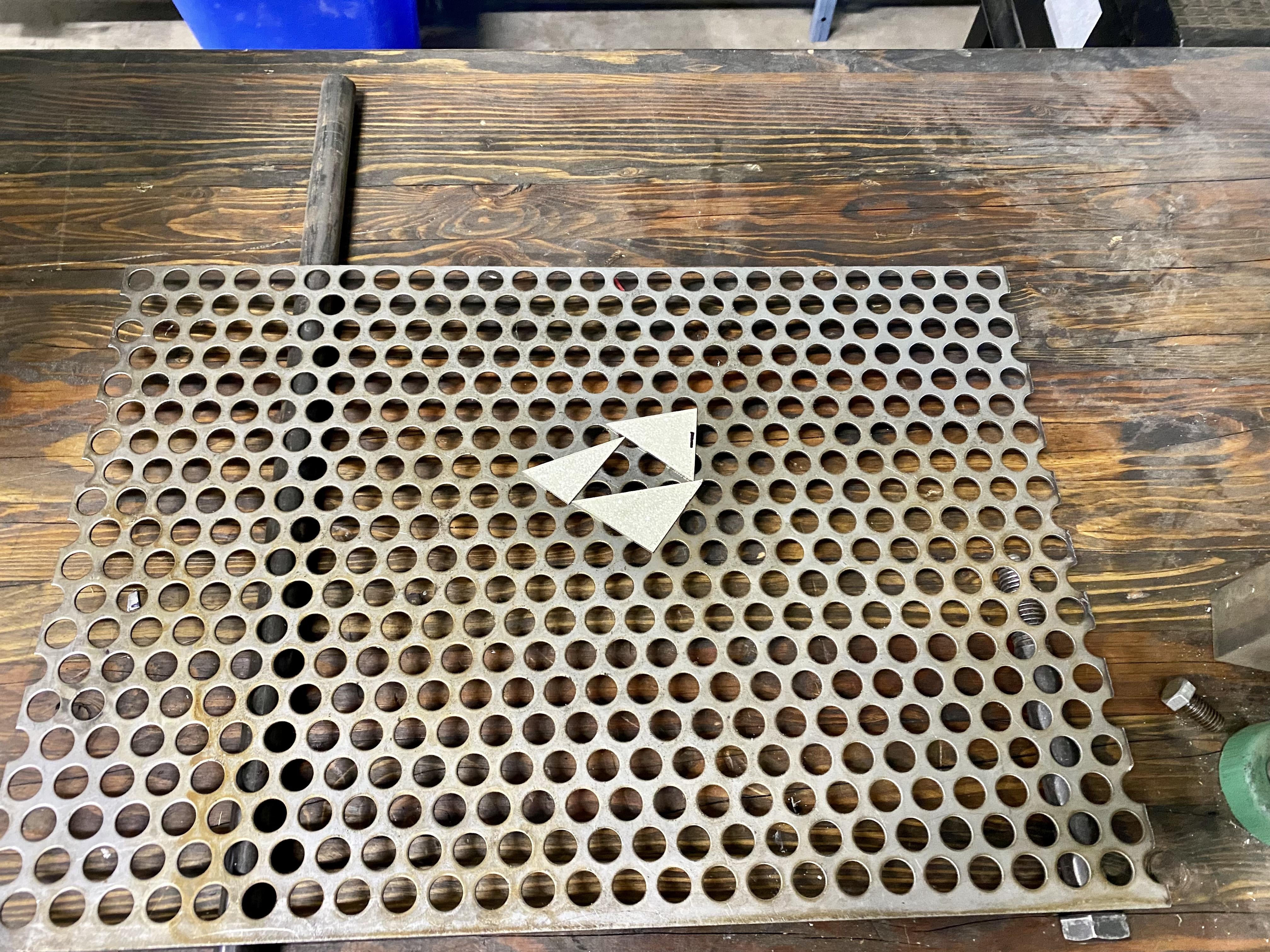

    I'm MIG welding a privacy screen (5' x 5') with some artsy triangles made out of 12 gauge cold rolled steel. My thought is to spot weld at each location where the triangles touch, including the frame, and call it done. Any suggestions on how to keep the entire 'sheet' of triangles flat as I weld this? I included a photo (still in process with a rough layout as I continue to cut more triangles). The goal is to have each triangle touching on all three corners.

    I'll definitely practice on some scraps. I don't want to vaporize the narrow points. I like the idea of aluminum underneath but I don't have any, maybe something to look to though. Because it is 5' x 5' I assumed I have to weld it while it's laid out on the floor. I guess I can put heavy scraps of steel on top of the pieces to keep them from buckling while welding. I don't have a spot timer (Millermatic 175) but I'll practice the timing.

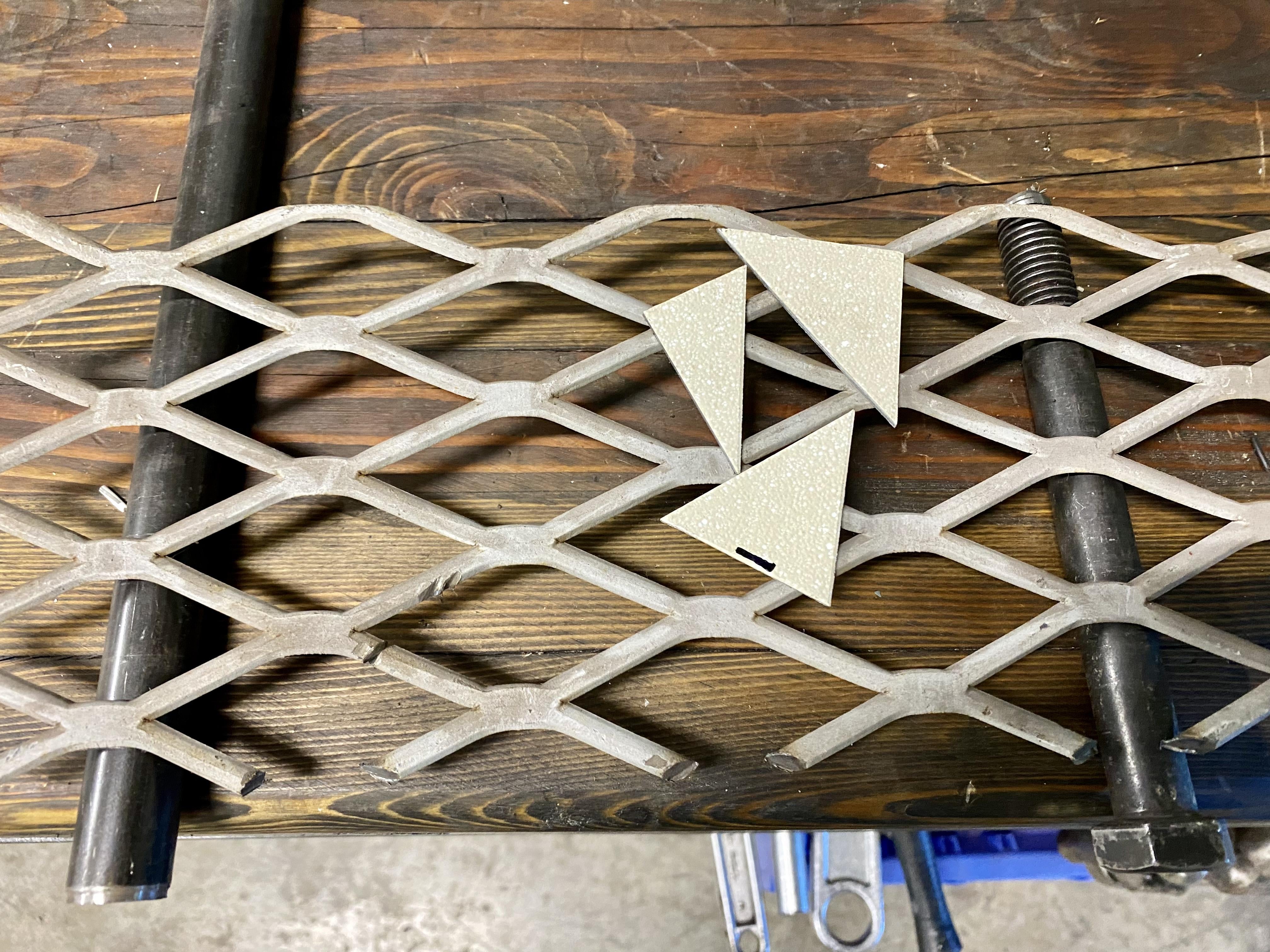

    Have you considered your design as an overlay on expanded metal or perforated sheet?
    It may not be the look you are trying to achieve but would provide structure and flatness.

    Lis2323, using flattened expanded metal seems the best to me. I would definitely ground each piece separately. One common ground could result in arc jump and spatter.
    Using a third arm with small ground clamp attached would hold piece where you want it. I posted my small ground clamp before and think this would definitely make it easier .
    Tacking the points could be challenging. You'll probably get discoloration and even penetration showing on bottom side.
