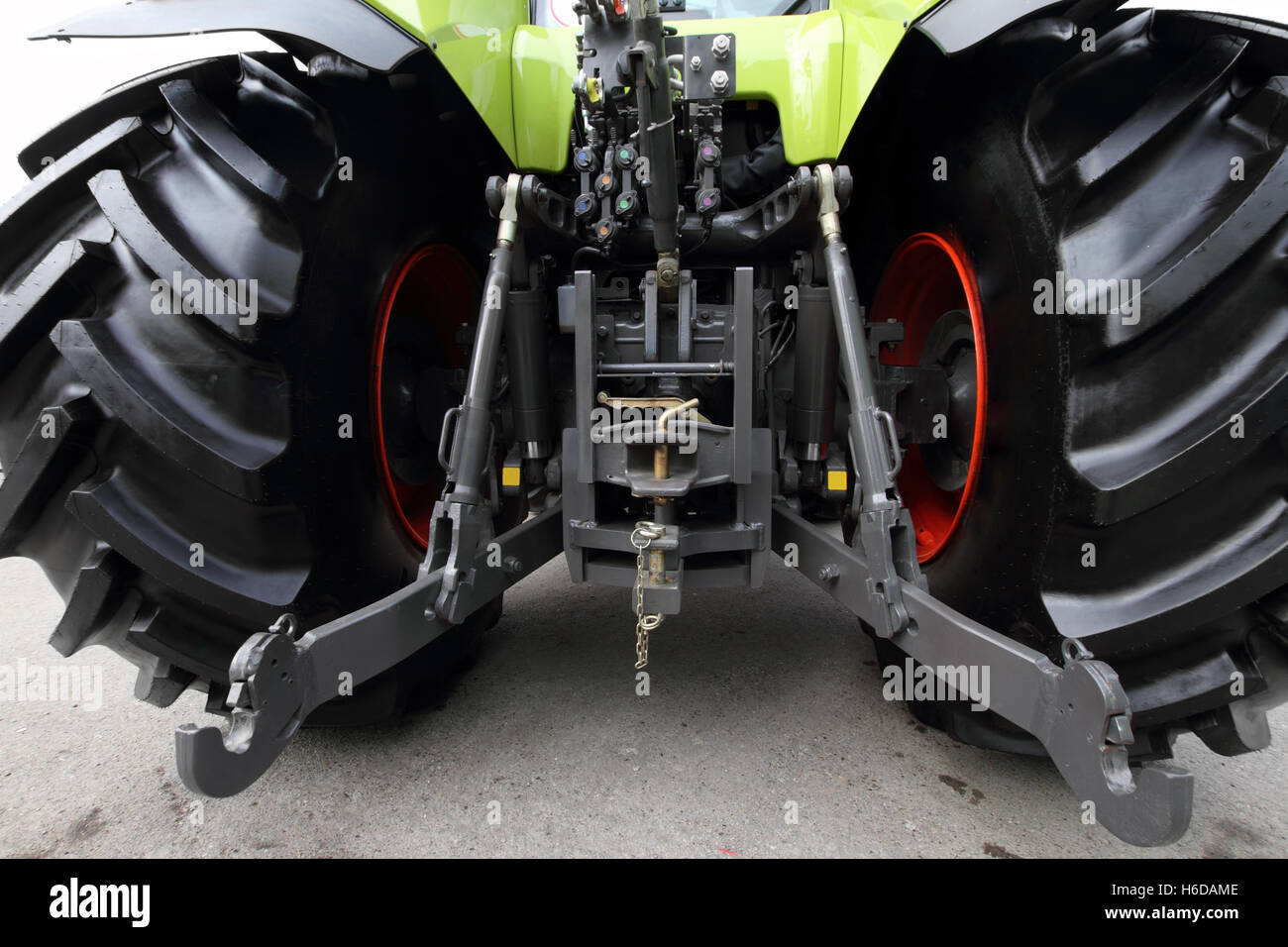

    All our newer tractors have these types of hook ends
    Balls go on the implement, and you just drive up to the implement, wiggle a bit and lift... then put the top link on seperately.
    I like that! As usual I’m late to the party!
    Na, not late,, just early for the next design to come along,,
    After having the Pat's, I can not imagine being able to hook up anything to that European "ball hitch" without two people,,
    How do you guide those hooks onto a ball,, TWICE! (once for each side)
    At least the Pat's has the bar sticking up to "catch" the implement.
    and,, the Pat's comes with an adjustable link, so that you can space the arms apart, as needed,,
