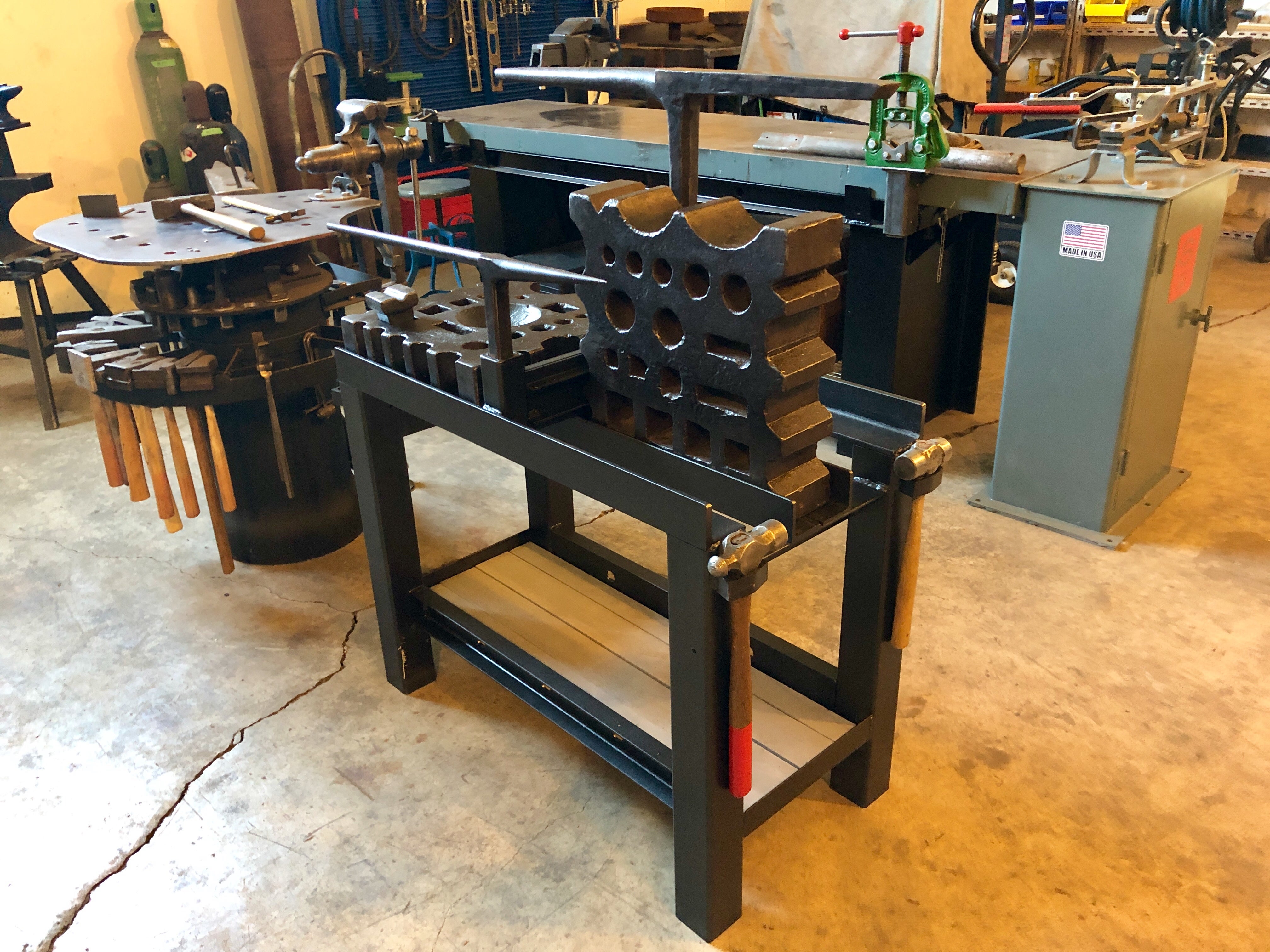

    You don't need a swage block to make skillets.
    Holland Anvil makes a nice swage block with dishing hollows already in place. For the money, it'd be a better investment than trying to make your own.
    You can also use the bottom of a O2 tank or similar cylinder. A "metal stump" is very handy to have in the shop and we've discussed this in the sticky thread on blacksmithing tools.
    Black Bear Forge has shown how to make a skillet without a fancy swage block. Most of the problem is just getting used to doing it since working sheet isn't something most people deal with regularly.
    If you have a welder, you can make forms from bar stock and weld the seams together.

    I was going to mention the Holland anvil swages....pretty nice for the price and a lot easier than trying to make one.
    For the folks asking about rebound...swages don't require rebound like an anvil as you're not doing that sort of work on them. Many were made of cast iron, ductile iron, etc. As noted, stumps and big chunks of wood with shapes carved out can serve as a swage for many projects.
    I don't think you'd be too happy with the product if you try making one out of a laminate that size. Welding along the perimeter is probably enough heat that it's not going to be flat/square afterwards, which is going to increase the amount of machine work required to get it square again. First you'd have to get the plates perfectly flat, weld them together, then get them flat again, then machine in the shapes...and it still might not turn out that well. I'd be worried about how thin the top plate would be in the areas you dish out the most.

    What Vaughn said^^^^ but for those unfamiliar with swage blocks....
    These are 200 pounders
  25. Likes whtbaron liked this post

    Chris, I think you are over-thinking and over-engineering this.
    Vaughn had some good suggestions. You will be forming thin steel, probably around red hot. Many smiths just make skillets cold-formed! The "swage block" can be just plain mild steel. You can form your skillets, hot metal or cold thin metal, without any kind of alloys or heat treating of the block. I form my dish shaped items on a hollowed out stump! Don't worry about rebound; you are not forging thick stock. Stack your three plates, weld them together along the edge seams, have your friend machine out the curved depression to your specs, and forge away! If you are worried about ridges forming on the outside surface of the skillet from the inside seams, run a bead around the inside seams, grind and polish. The gentle forging you will be doing won't destroy the beads if they are thick enough.

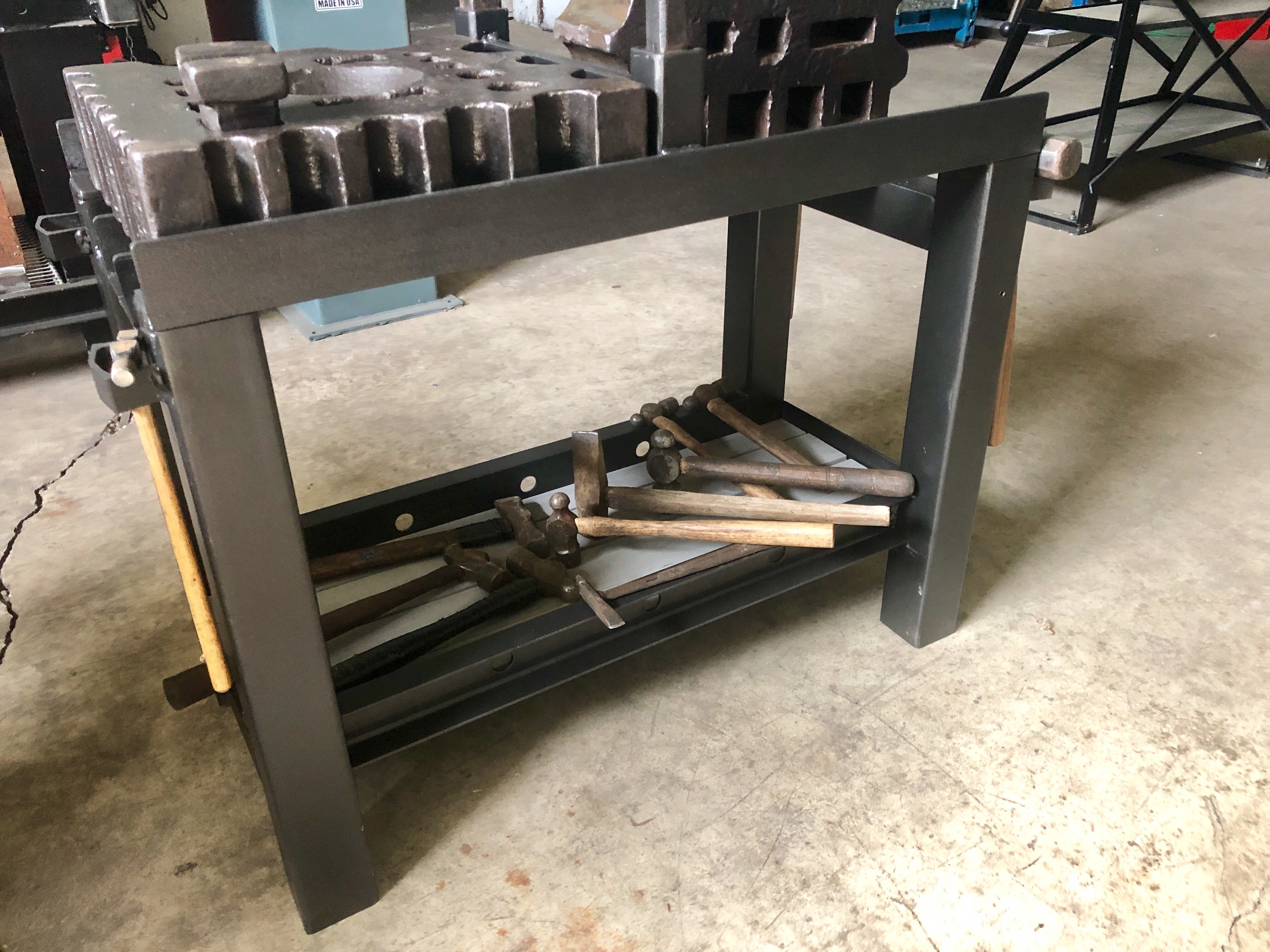

    1,922
    Re: Swage block

    Would olympic style weight work for swage. Can they be machined and beat on? Comparably cheaper than steel. If you find a scraper, then really cheap.
  32. #25
    Aug 2012
    AR
    2,468
    Re: Swage block
    Cool idea, Vaughn!
