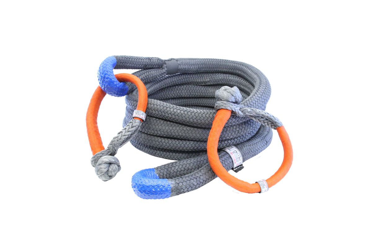

    If one wants to see soft shackles put to hard use, go over to youtube and check out some of the videos by "Matt's Offroad Recovery" in Utah. He uses kinetic ropes and soft shackles to pull the most gosh-awful vehicles and heavy vehicles out of some of the worst stuck places.
  17. Likes 12V71, VaughnT, 52 Ford liked this post

    Quote Originally Posted by shortfuse View Post
    Or that HeavyD Sparks fella.
    Ripped the body right off the frame, popping rivets like I pop ibuprofen!
    Those Yankum ropes and shackles are pricey as all get out, but they sure seem to work. The guy literally just tore steel apart, but the plastic rope not only took the load, but excelled at the job! Blows my mind to think that plastic stuff can be so much stronger than steel, but that's kinda hard to deny after seeing steel ripped apart like that!
    Gotta admit, I do like the fancy coatings they put on the stuff to help with abrasion and UV resistance.
    I've made small soft shackles out of Parachute cord and found it a great way to hold light loads. The ones I make from 1/2" woven line are stout, for sure, but also just plain big, too.
    1/4" or 3/8" rope is usually more than strong enough for most applications. As Pat says, you have to be careful about leaving the stuff out in the weather for months on end where the sun can turn it brittle. The upside, though, is that they are so easy to dismantle and stow away in the truck that you really don't mind tearing things down so you can stow it away.
    I've always hated having toolboxes filled with everything that rattles as I go down the road, so using soft line and simple rings has been a huge bonus in that regard. It's not that I need the stuff, but it's just so easy to stow under the seat that you can't really justify not having it since there's no noice or weight to worry about.
    Looking at that snatch block on the first page, I'd have no problem pulling out that pin and removing the hook so I could use a rope loop in its place. You'd have to go over all the edges of the side plates to round them over, making sure there wasn't anything to cut the rope, but it'd be easy work especially for a short-term fix if time is of the essence. A Prusik Loop made from 1/2" rope, or larger, would be more than enough to hold the load in question, moreso if you put it in some kind of hosing to protect against UV and abrasion.
    Then, whenever you're done with it, just pull the pin again so you can remove the rope, keeping it stored in the glove box until you needed it once more.
    If you watch any of the arborist videos, they basically do exactly that. The block is attached to a rope that's attached to the tree as the anchor point. From there, they can raise and lower hundreds of pounds of wood, the snatch block rotating however it wants because the connection to the tree is so very flexible.
    Seems like that's exactly what's needed in this application. While the block certainly needs some smoothing of the rough edges, that's a quick job with an old flap disk. Ten minutes and you're up and running. It'd take longer got get through the check-out at the hardware store than it would to fix the block.
    The kinetic ropes he uses are made by Yankum. Though, I'd probably buy the Matt's Offroad Recovery edition one, just to support them. Seems like they do a lot of good stuff for their community.
